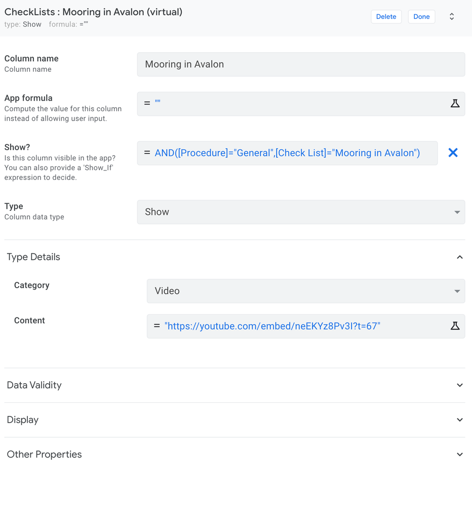

Iโ€™m using a Virtual Column, type Show, category Video. Found that you have to use the correct YouTube link: https://youtube.com/embed/....whatever the video Id goes here. I tried using the youtube feature of setting the time of the video start but it doesnโ€™t work. video starts at the beginning.
On my iPhone the video will expand and rotate to take the whole screen. Havenโ€™t tested Android yet.

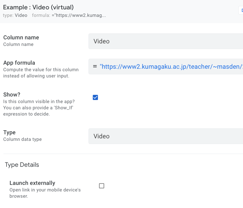

Hi @Mike_T ! Your post prompted me to revisit the the โ€œvideoโ€ column type. In the past, I had had trouble getting mp4 video files from my server to play in it. Today, however, I found that it works very well. I tested it on my iPhone and on an old Android device. The video played in place in Android and zoomed to fullscreen on my iPhone as soon as I tapped on it. I assume that some fixes that I was unaware of took place on the AppSheet side; itโ€™s been a very long time since I had trouble with mp4s playing in my apps.
By the way, I also confirmed that an mp3 audio file (again, one I put on my server) will play in a video column. Itโ€™s not ideal โ€“ takes up more space than should be needed and, on my iPhone, goes meaninglessly to full screen โ€“ but it works.

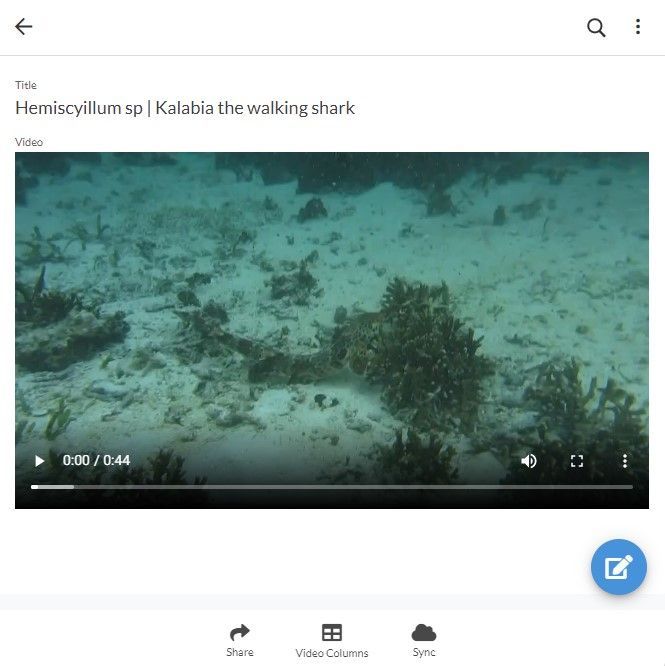

This is a really efficient workaround. One issue that I am facing, however, is, that I would like the video to be visible inside of the details page. Currently, whenever I add a file in the form, the video only renders in the form after I save it, and I can only view the video when in the form. Is there a way to implement this functionality such that I enter a file in a form and then it renders in the detail view for that record?
Itโ€™s what itโ€™s supposed to do. At least, thatโ€™s what I see on the demo video in the first post.
==> you see the video in the detail view.
If you donโ€™t have this, can you share a screenshot of your situation ?
Yes, I do see the column name โ€œShow Videoโ€ in the column order view option. Here is what I am currently seeing and getting as a result with my current state.
As you can see in the second image that there is no render of the video from the file that I have uploaded.
Check if your Detail View includes the Show Type Column that points to your video in the Column Order config
