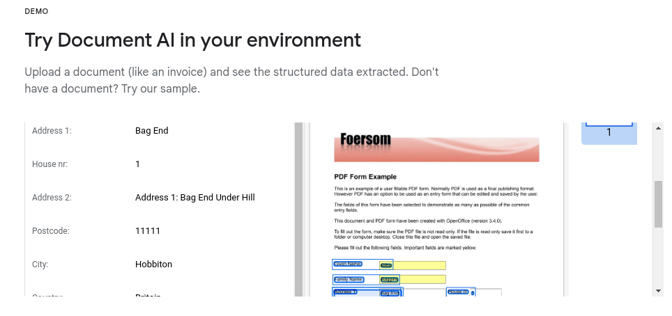

Document AI can easily and quickly process PDF and image scans of forms, and return very accurate extracted data of all of the form values. You can try it for yourself at https://cloud.google.com/document-ai and upload your own PDF to test and see the extracted form content.

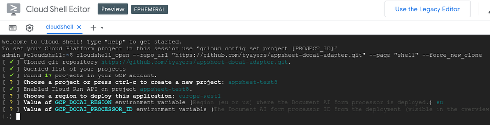

To deploy the adapter go this Github project (don't worry, you won't have to touch any source code), and click the Run on Google Cloud button.
After clicking the Run on Google Cloud button, trust the repo and authorize the Google Cloud Shell session, and then select your project to deploy the adapter to. I will be deploying to appsheet-test8.
Then choose a region to deploy to. I will be using europe-west1.
Now enter your Doc AI Region and Doc AI Processor ID that we saved from Step 1.
Now the service will build and deploy to your chosen region. This can take 3-5 minutes.

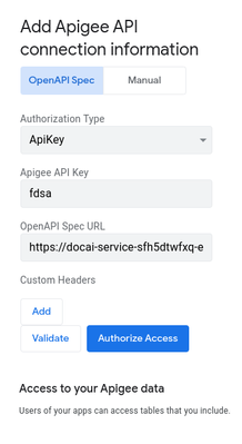

b445cfef-46a4-4105-8130-6050e9fdfbc7.pngNow go to your AppSheet Account Sources, and click + New Data Source. Enter a name like Doc AI Service and click Apigee. Apigee means add an API that AppSheet can use like a normal data service (and check out the Apigee service in Google Cloud if you are interested in a full API solution, however for this solution we are just using the data source and not the full Apigee service).
Now add the URL from above into the OpenAPI Spec URL field, and enter anything into the Apigee API Key field (it's not valided in this sample project, please add for production use-cases), and then click Validate, and Authorize Access.

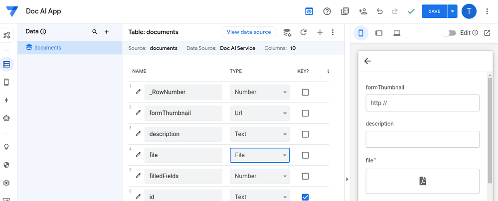

Now the app will be created. Initially there's just some test data in the app. Open the data configuration, and change the file column to File type, and also set the field to not required (can be adjusted later).
Now click the file button in the app preview to upload a file - just choose any test PDF like this one. After uploading and saving the record, you should be able to open the newly created record and see all of the form fields processed in the app.
