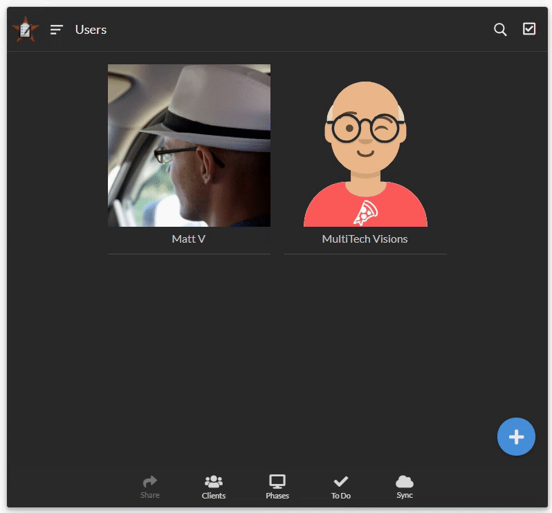

Here’s the process and what the behavior looks like in the end
