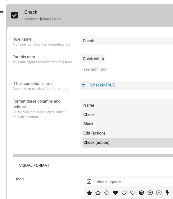

Now, go to UX โ†’ Format rules and make the following format rule:
This way, when the action does itโ€™s work and changes the โ€œCheckโ€ column value to โ€œTRUEโ€, the icon will change to a box with a check in it. It will revert back to an empty box (and the โ€œCheckโ€ column value will go to โ€œFALSEโ€) if you tap on the action again.

Now goto UX -> Format Rules and create new format rule
in formula tab write [Check] = TRUE
next provide our newly created action to it
for icon use check-square
we can check and un check now

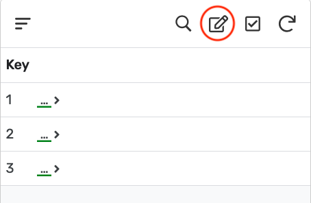

You could always do a quick edit table with yes noโ€ฆ Itโ€™s a checkboxโ€ฆ
I see. Itโ€™s a great checkbox, but you need to tap on the edit icon first. Thatโ€™s one difference.
By the way, I couldnโ€™t figure out what caused the horizontal dots to be shown instead of Y or N. I tried โ€œSave & Verifyโ€ but to no avail.
It looks bug to meโ€ฆ
By the way, the action icon at the upper right corner to enable the quick edit to table view you are on is not really recognizable to my end user and clients. I always need to guide them and explain to them hit it !!! Then you are able to get the exprerience like you are on the spreadsheet.
To make this action icon action stand out, I place the action icon in the overlay position.
The action is simple enough. Go to another view but actually return to the same view.
The deeplink expression is
LINKTOVIEW(โ€œYourTableViewYourAreOnโ€)&"&quickedit=true"
