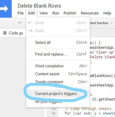

To make this run once a week, you need to open the spreadsheet containing your data. Go to Tools > Script Editor in the menu and add the code I pasted above. I named the file โ€œdeleteBlankRowsโ€. Now you need to set the trigger. From the script editor menu, select Edit > Current projectโ€™s triggers. In the lower right corner, click the blue button, Add Trigger. On the pop-up form, select Time Driven for the Event Source. The other options are pretty clear.

This is what Iโ€™ve been looking for years !
However, I cannot open the โ€œCurrent projectโ€™s triggersโ€.
It would have driven me crazy if I could not clean up the empty records!!

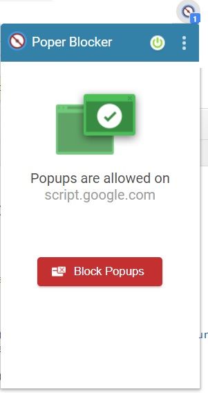

I donโ€™t know why you canโ€™t open โ€œCurrent project triggersโ€. It should be available under the Edit menu in the Scripts editor, not the menu for the sheet itself.
I found the problem. Itโ€™s because of a Chromeโ€™s extension. Iโ€™ve to allow pop up on script.google.com in order to show the triggers tab.

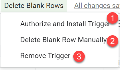

I can not help myself to share and to add more flexibility on this discussion, you might want to have several menu in the sheet itself.
Such as:
after copy and paste below script and save the script, refresh the google sheet, you will see the menu in google sheet:
  1. Click โ€œAuthorize and Install Triggerโ€, for initialization. The trigger will automatic installed and triggered every Sunday at 09:00 and a pop-up will appeared on the google sheet for successful installation.
  2. Sometime you also want to manually delete the blank rows (if you donโ€™t want to wait for Sunday to come. Click โ€œDelete Blank Row Manuallyโ€.
  3. Sometime you just want to remove the trigger.

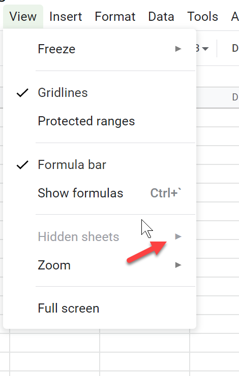

Does anyone get the error message " Exception: You canโ€™t delete all the rows on the sheet." when running this? It works but I always get this error when running it manually. After looking it up, it appears the error may stem from the โ€˜forโ€™ loop.
I am on an iPhone so I canโ€™t check script, but are you trying to execute this on a sheet that has no content below a header row? I didnโ€™t see any error checking so you might be trying to delete ALL rows in your sheet which is not allowed (must have at least one row). Add a few rows to your sheet and see if it runs. Just something to check.
Hi @Jordan_Davis1,
Iโ€™m not 100% sure, but I think you would get that error when the sheet has no data in it. The problem is that the script wants to delete all the rows in that case, but at least one row is always required.
Hey Greg and Mike, thanks for the feedback. I have about 10 sheets in the whole workbook and they all have hundreds of rows of data including header columns so Iโ€™m not sure why Iโ€™m getting this error.
Is it possible, there is a hidden empty sheet?
Wow, i didnโ€™t know about hidden sheets. You found the issue, I had a blank hidden sheet. Thanks so much!!! It works now.

Hi hru, could you advise if the scripts will delete blank rows of all sheets in a spreadsheet ? Thanks.
@hru wrote:
  • Click โ€œAuthorize and Install Triggerโ€, for initialization. The trigger will automatic installed and triggered every Sunday at 09:00 and a pop-up will appeared on the google sheet for successful installation.
reg,
