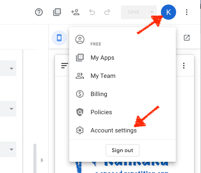

Part I: Preparation
The image in this post are, for the most page, based on images in the following post by @Steve:
Deploying a sample App for free from a free subscription plan - #3 by Steve
Since first publishing this post, the editing interface has changed quite a lot so I've replaced Steve's original images with ones that I have made using the new interface.
In Steve's original image, upon which mine is based, he had the authentication provider to “any provider” but, since I only work with Google sheets, I usually have this set to Google.
Note: Though you need to click on a button that says "Change visibility," turning on "Make this a public sample is NOT (by itself, at least) what makes your app appear on your portfolio.  Your app will only appear on your portfolio if it is also deployed (next section).  Conversely, after you have made your app public, you can take it off your portfolio by reverting from "Deployed" status to "Prototype" status.  If you want to stop people from copying an app you have made public (either on your portfolio or separately, as explained in IIb), you should probably make a separate copy for yourself and then erase the version that you made public.  The reason is that if you have acquired users while you app was public and you have a "free" account, you may get an error saying that you need to switch to a paid plan.

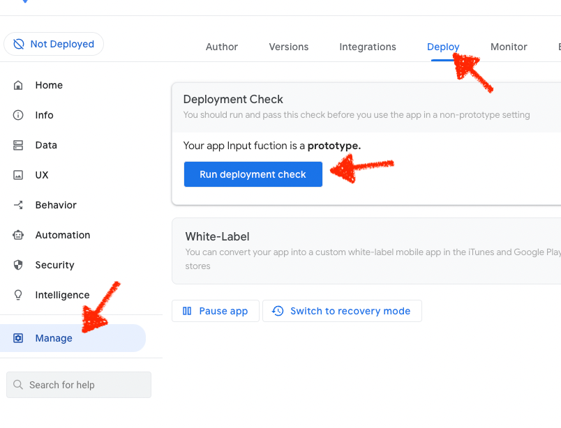

Part IIa: Deploy
Deploying your app causes it to appear on your portfolio (assuming you have followed the steps in Part I). If you skip this section, your app will not appear on your portfolio but you can still share it via a URL (Part IIb).
These images are also based on those in Steve’s post.
Screen Shot 2022-09-13 at 13.45.03.pngScreen Shot 2022-09-09 at 17.34.58.png
By the way, it has been my experience that even if my app “fails” the account status part of the deployment check, I can “go ahead despite errors” on my free account if I have followed all of Steve’s steps. This is another way in which AppSheet can be rather inhospitable (unintentionally, of course) to people who are interested in sharing their work for free. (Attention: @Peter ; Ref: September 14, 2021 - #23 by Kirk_Masden)

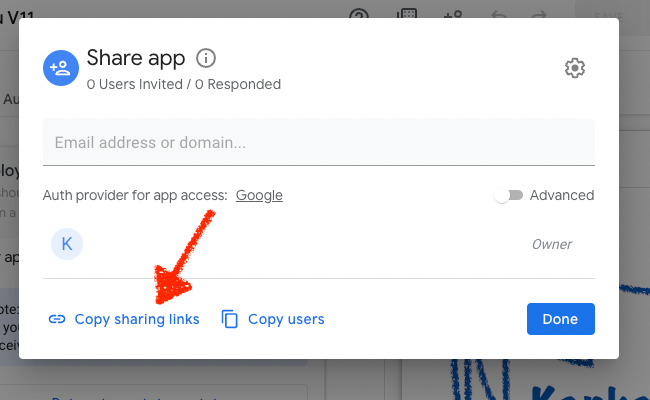

You can find your appGuidString here:
The appGuidString is everything after the last slash.
