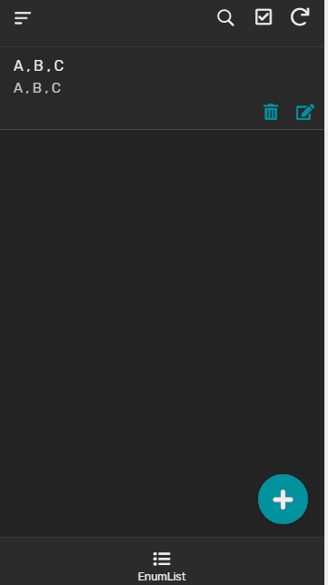

How to use depended EnumLists in the same Form without using Ref
If you add a new entry in EnumList1, you can select it also in EnumList2 and visa versa.
It’s also sorted alphabetically.
For that you don’t need any Ref Table.
Expression in Suggested Values in EnumList1:
SORT(
LIST(
	"A",
	"B",
	"C"
  +SPLIT(EnumList[EnumList1],",")
  +SPLIT(EnumList[EnumList2],",")
  +SPLIT([EnumList2],",")
  -LIST("")
And in EnumList2:
SORT(
LIST(
	"A",
	"B",
	"C"
  +SPLIT([EnumList1],",")
  -LIST("")
Check out the sample App “EnumList” in my Portfolio:
https://www.appsheet.com/portfolio/549987
