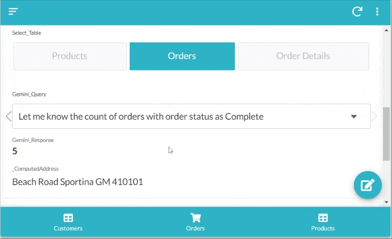

Below are  2 GIF to see the app in action. To save time , I have purposely created a few questions with enums as input queries. Once the app table to analyze is selected and the question asked the Gemini API responds in around 3/4 seconds with anser in the column [Gemini_Response]

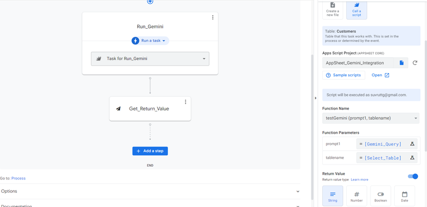

The bot event triggers on the condition
AND([_THISROW_BEFORE].[Gemini_Query]<>[_THISROW_AFTER].[Gemini_Query] ,
ISNOTBLANK([_THISROW_AFTER].[Gemini_Query])
When the user enters his query ( or prompt) in the [Gemini_Query] field the bot triggers.

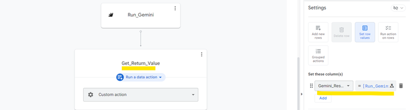

The step Run_Gemini calls the GAS , passed two fields [Select_Table]  (table to analyze) and [Gemini_Query] or the prompt to prompt1 and tablename fields in the GAS.
The step is also enabled to process return values from the GAS
The step "Get_Return_Value" sends the output of the GAS (which is nothing but the answer) from the Gemini API back to AppSheet app field [Gemini_Response]
