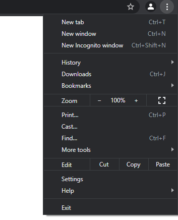

  1. Open the URL of your app
  2. Click of the dots at the right side of the browser:
  3. Go to More tools → Create shorcut
  4. Check “Open as window” and “Create”
  5. You will see the app opened on a window and you will see also a desktop shorcut on the desktop as well as under the windows menu → “[NameOfYourBrowser] Apps”

I’m just adding an update that no one asked but I found useful
Since Method 2 is a little bit hard, you can do the following to change from Method 1 to 2 kinda easy:
Find the desktop shortcuts made by Method 1 and open it’s properties:
Change the:
--app-id=whateveritsayshere
to:
--app=https://www.appsheet.com/start/XXXXXXXX-XXXX-XXXX-XXXX-XXXXXXXXXXXX
That’s it
Hope this helps if Method 2 was a little bit scaring
