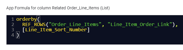

~ The ORDERBY() Formula ~
In addition, you’ll need to adjust the REF_ROWS() formula on the Order table
Summary
  • You need to include an ORDERBY() to ensure items are STORED in the correct order in the lists
    • This way, when you set the sort number of the seventh item created to 1 - that item sits in the 1st position instead of the 7th inside the VC.
  • Otherwise, all the actions (to adjust the sort numbers of neighboring items) won’t mesh right.
Check out the [Related Order_Line_Items] VC in the Orders table

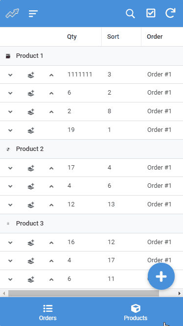

~ The Table View ~
The final bit of the puzzle is to conform your table view
Summary
  • Make sure you sort by the [Sort Column]
  • You can show the sort column if you want (it never changes though - or appears to never change, as the sort numbers are always in the correct order).
Check out the Order_Line_Items_Inline view

I have updated the Products table to include manual sorting there as well.
  • This demonstrates how to accomplish this trick when you don’t have a parent-child relationship, but still want to have buttons to sort things.

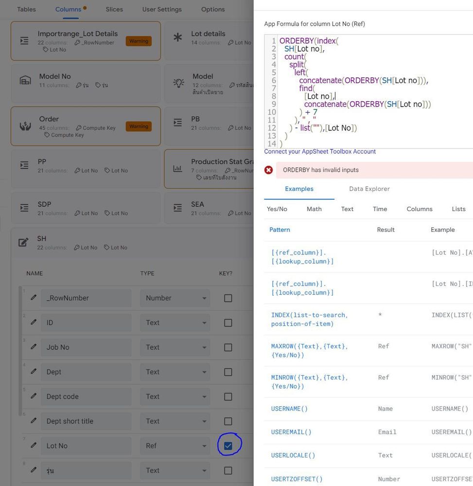

I thought having parent child relationship will badly affect on the performance. That is why I tried to experience this trick without ref table.
Actually my table has more the 500 rows and now I feel it is better to use your original trick which is working well in my case.
Thanks for sharing this useful trick and I appreciate your quick reply to my questions with very detail explanations.
Hi @MultiTech_Visions,
In my case, I want to group items and sort within the group. I tried it with this trick but seems not working. Is there any thing to be changed in expressions to achieve this.
What if my key is REF? How to make the ORDER BY FORMULA run correctly? Right now it said invalid ORDERBY formula? Please help
my data has no ref table
I stuck with the order by formula. Please help
My data has no ref table
Mark_S
Very clear. That’s what I wanted to know. I will try and let you know. Thank you

@Mark_S This get’s much more complex, but interestingly enough it’s actually how the original implementation I made works… in a way.
For grouping to work, it’s best to have an actual Ref parent-level
  • This way you have all the [Related Items] for each group inside a list on the parent’s level
    • making it much easier to accomplish batch changing.
This is actually a much more complex system, and for that reason I chose to not include it originally.
  • To make this work smoothly, you really need to think about things at two levels
    1. The Group level (which needs it’s own sort number); and
    2. The Item level (which has it’s own sort number within it’s group)
You need to combine these two together to create a “Global Sort Number” in the form of a decimal; where the “full numbers” - the numbers on the left side of the decimal point - represent the group sort number, and the individual item sort numbers are used for the decimal numbers.
  • I find it’s helpful to use 2 decimal places for the decimal

@Fabian Actually you can see it in the gif you made compared to my original one.
3X_4_d_4dba49305a5a33429e4e68c3150210851ffe624c.gif 3X_a_e_aeed986bf799f9fa3313afeed739f070c7d44924.gif
Watch how long it takes when you tap an item before it’s moved…
  • Taaaap move. taaap move, taaaaaaap move (some longer than others)
Compared to the responsiveness of my original gif (which is actually modifying 2 records, not just one)
Boom boom boom - as soon as I tap the action, both rows - not just the one I tapped, but also the neighboring record - are adjusted; there’s no 1/2 second hitch.
I developed this technique in response to complaints from my users that, “moving items up and down in a list is taking too long.” I originally had something similar where I was doing SELECT() and things; I switched to this so things would be as fast as possible.
  • This method works well with large data sets because it utilizes de-references and text-manipulation formulas - all of which process really really fast. (Compared to any SELECT() you may run)
  • Additionally: when the formula runs, it’s only processing over (8) records (in the preview gif above) because there’s only 8 [Related Order_Line_Items] in the list.
    • Even if I had 20,000 rows in that table - the original formulas I propose are only working on 8.
  • And even then, it’s just taking the [Order_Parent].[Related Order_Line_Items]… CONCATENATE()ing that out into a text string a couple of times, and doing some FIND() and LEFT() stuff.

However, as Steve mentioned, the magical behavior does not work when I use ORDERBY(REF_ROWS()…). I have noticed that this works for parent-child relationship that is already created/added.
If I remove the ORDERBY, my app works and I can add new items as the autofill of column referenced works but the manual sorting does not.
If I keep the ORDERBY, the manual sorting works (and that too on older rows with parent-child relationship defined) but the autofill does not happen, and I cannot proceed without this.
Any workaround to retain both the magical part of REF_ROWS and manual sorting?
Two things you can do here:
  1. Make your own action to create a child record with the parent value pre-populated
    • Basically remove the original “Add” action from that context, and instead show an action you’ve created to essentially do the same thing - but this one is hard-coded to capture the ref.
  2. Move the ORDERBY() out of the REF_ROWS() and instead order everything inside the formula use
    • The idea here is to move the ordering formula from the root VC into each use of the VC
    • Go throughout your app, find every instance where you’ve called the VC and wrap THAT use in the ORDERBY()
      • You can see how this sux as now you’ve got to replicate that orderby() several times over, but this will retain the ref-magic while still allowing you to get things in the correct order.
