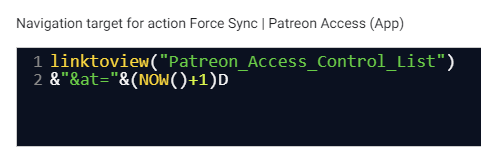

If you create a DeepLink formula to take you to a view, you can add a little bit of code to the end that ensures that the data on said view is updated as per a timestamp.
&"&at="&(NOW()+1)
@Aleksi came up with this years ago, and it works wonders

Hey! Using CONTEXT() I donโ€™t need to hard code any view
CONCATENATE(
  LINKTOROW(
    [_THISROW],
    CONTEXT(VIEW)
  "&at=",
  (NOW()+1)
I just need to clone/copy the action to every table I need it

The Deeplink to accomplish this โ€œForce Syncโ€ action is basically better used on a grouped action to make sure the app updates after other actions have been made, if you use it as a โ€œnormalโ€ action, itโ€™s basically another way to click on the top right corner button to sync.
Now, here the update, if you want to use it on a grouped action, it should be used at the end of it since the sync will stop any other action after it
