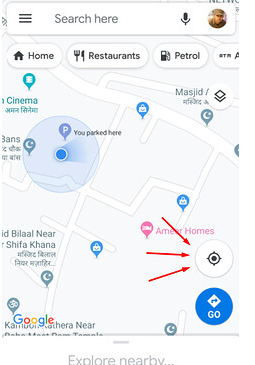

There is no way to jump to the current location in a map, like we have in google maps.

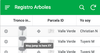

Hi Fabian, the LINKTOVIEW at the top works like a charm. Thank you for that. But the XY related solution with LINKTOFILTEREDVIEW keeps putting me into the middle of the world map. Arbol = tree and Parcela = plot. Here is the expression I used from your example:
LINKTOFILTEREDVIEW(Mapa Parcelas , ([Parcela ID] = [_THISROW].[Parcela ID]))
&’&_currentLat=’&((LONG([_THISROW].[Parcela XY])/10090-45)/2)
&’&_currentLng=’&(LAT([_THISROW].[Parcela XY])/100
90-45)
&’&_zoom=2’
Besides that, I do have one additional issue that I posted in another thread. Maybe you have some advise since you have posted a lot of helpful map related topics. And I think it may be the root cause of the above issue. Some missing references I think between the parent and child table.
I can’t manage to successfully show parent table background maps (plots) with child table XY data (trees) in a parent table view. It does work well the other way around showing trees on their plot from a child table view.
I can only imagine that I may need to add virtual columns to pull data into the parent table. But I am not sure where to start.
Thank you.

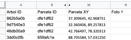

Hi @Christian sorry for my late reply.
You can’t mix XY and LatLong. A world map uses the usual geo coordinates with LatLong. XY uses coordinates from 0 to 100.
So in your case you can use this expression:
LINKTOFILTEREDVIEW(Mapa Parcelas , [Parcela ID] = [_THISROW].[Parcela ID])
&'&_currentLat='&LAT([_THISROW].[Parcela XY])
&'&_currentLng='&LONG([_THISROW].[Parcela XY])
&'&_zoom=17'

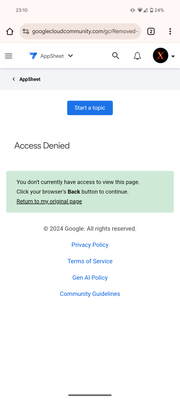

Here is a workaround how to put this action directly on a map view:
https://www.googlecloudcommunity.com/gc/Tips-Tricks/Jump-to-your-current-location-in-a-map-view/m-p/...
 i can't access this particular link.
Thank you @OptimiX_XcrY the system deleted the post. But now it's restored again.
