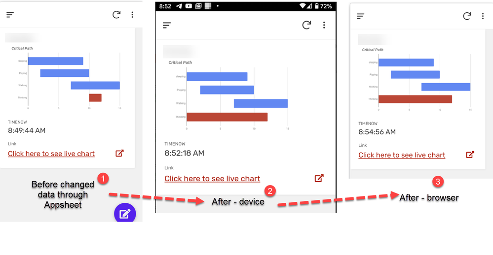

I am sharing a workaround to be able to get updated image google-sheet-chart in Appsheet, result is as below picture, data was updated through Appsheet and in about 5 minutes or so (after sync) the chart-image get updated:
Iโ€™ve tested using my device and also in the editor.
To see a live update of the chart, a link is being provided which will get an instant update. In browser, when click the hyperlink it will show something like this:
Test the-link-here.
This workaround is with following steps of changing the URL:
  1. For the embeded image-chart: need to add to the URL of the published chart image with
    image&update=&NOW(), sample as below:
"https://docs.google.com/spreadsheets/d/e/2PACX-1vSaTE8IT7Z4bj_8FhrgSX5CpKruu-Qzln5_PLOQBHC7LateshFRJB4f_7Z-S70_wtO7hZzI0Jxc0rJX/pubchart?oid=1933246888&format=image&update="&NOW()
  1. For the hyperlink, adjusting based on a Medium-post:
Step 2.1. Copy the chart and move to a new dedicated sheet
Step 2.2. Following the Medium-post, Change the "edit#" with "htmlembed/sheet?"
So the final upadated URL will be as sample below:
"https://docs.google.com/spreadsheets/d/1B3cx1d5VI-Yf4npuDyUnbNXGmpp85XSF1codvTY9IxA/htmlembed/sheet?gid=2105918318"
as shown with the above.

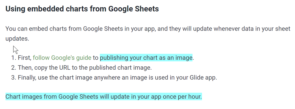

It seems they are doing โ€œsomethingโ€, at least in the formal document they have โ€œguaranteeโ€ every hour of image chart update.
Appsheet auto update every 30 mins.
Google Sheet published Chart URL seems to refresh cache once every 5 mins. based on that, appsheet view with google chart will be freshed every 30 min without explicitly syncing app?
