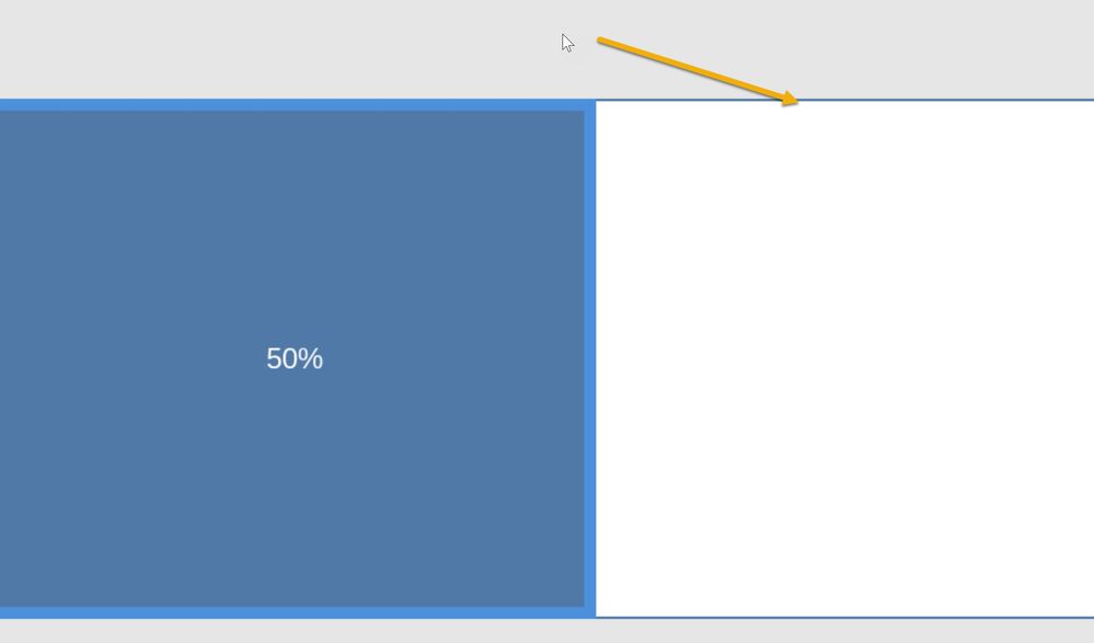

Has anyone figure out how to change the main bar border color?
I have this code but the the borderColor applied only to the progress sub-bar (blue sky color):
https://quickchart.io/chart?c={
	type:'progressBar',
	data:{
		datasets:[{
			data:[50],
			borderColor: ['rgba(72, 145, 219, 1)'],
			borderWidth:5
Thanks!

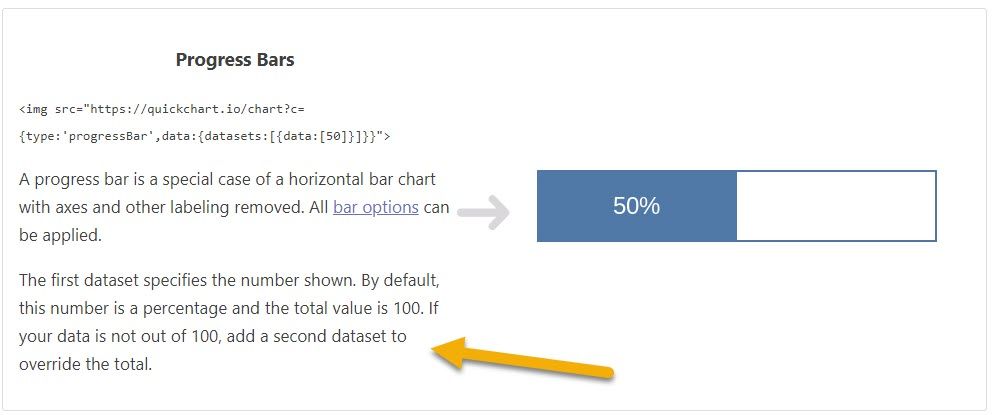

Also did you always use this for percentage progress? I canโ€™t find how to indicate my own progress value and total that is not percentage.
https://quickchart.io/documentation/
