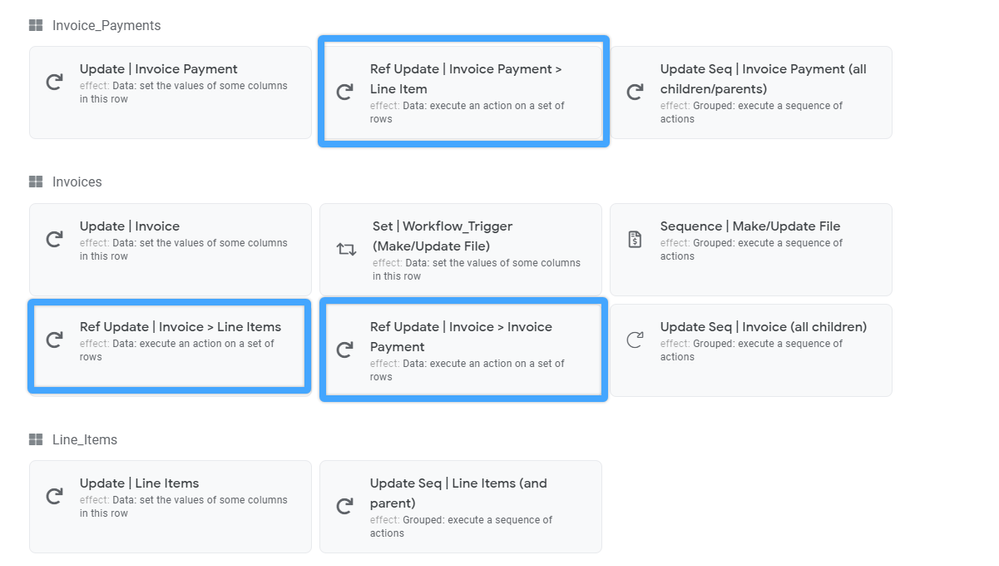

My naming convention for Update actions is the following
  • Update | Name_Of_Table
My naming convention for reference update actions
  • Ref Update | Triggering_Table > Updating_Table

You can easily update all the child records from a parent-child relationship inside your app
All you have to do is create a reference action that runs the update action over the [Related Child_Records] column.
What do I do when I’ve got more than one related table to update?
When you’ve got more than one [Related Whatever] column (and associated tables) that you need to update, the process is relatively the same - you just have to add in a composite action into the mix.
