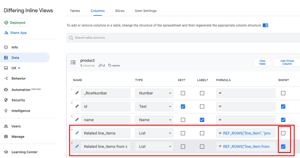

Next, in one of the parent tables (I chose product), create a new Virtual Column. You’ll copy the REF_ROWS() expression from the existing “Related…” VC, and simply change the table name to the name of the new slice.
REF_ROWS("new slice name" , "ref-column" )
Hide the original "Related..." VC, and show the new one.

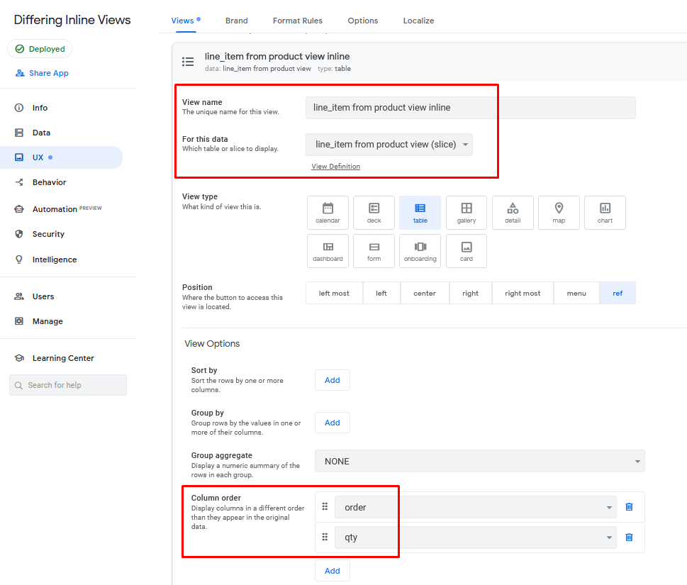

Create your own inline view for this new slice, however you'd like.
Now you will see different inline views, based on which parent record you are viewing from

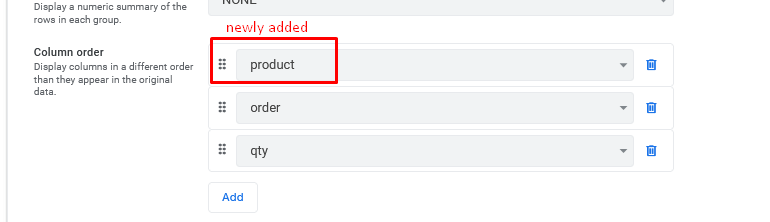

What I found particularly annoying is that when you click on the View button on the Inline view to see more rows, the appearance of the key column behaved differently.
For example, if I was in a Product Detail view showing the line_item Inline table, when I click View to go to the full-screen view to see more rows, I want the Product column to show as a reminder of what Product was being looked at (yes it is needed).
In the Detail view’s Inline table, I don’t really need to see the Product because Product is being shown in the Detail view above.
HOWEVER, what I found was the Product column would show in the Detail view Inline table but would be automatically removed from the full-screen view, where it is needed the most. I believe the behavior should be reversed. I think I ended up creating a “display” column to get around the issue.
But maybe this approach will resolve that problem as well?
