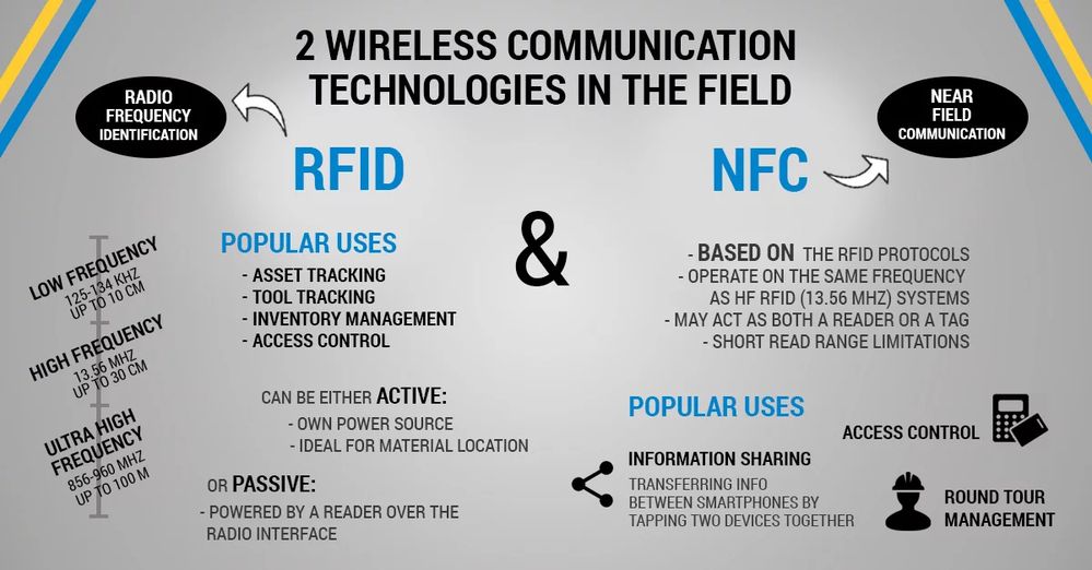

~15 minute screenshare with a primer on 1D/2D Barcodes and RFID/NFC technology and how to leverage this with Appsheet.
Links:

So well explained, now we just need AppSheet to read the build in UUID’s (or what it is called) in the NFC tags.

Provided you code a deep link with some default values to any NFC tag, the NFC reader automatically launches the AppSheet app and open that record/view etc.
