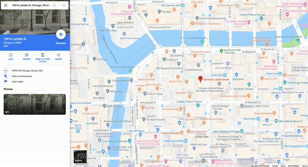

So what exactly do you mean by this?
I assume youโ€™re asking aboutโ€ฆ
That would be this:
All you have to do is literally concatenate() a string for a URL - then simply launch that URL. If G-maps is installed, it launches otherwise itโ€™s through the web interface.
