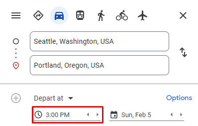

This method uses the Google Maps URL method, which differs from the Google Maps API method.
In the URL method you don't have the parameter "departure_time". (which you have in the API method)
Did anyone figure out how to use the "departure_time" parameter in Google Maps URL?
You can set this parameter in maps.google.com
And this gives you an URL

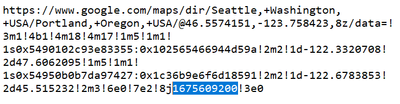

https://www.google.com/maps/dir/Seattle,+Washington,+USA/Portland,+Oregon,+USA/@46.5574151,-123.7584...
As you can see it uses the data parameter. And at the end of the URL you also have the Unix Time "1675605600". Of course you can change the Unix Time, but you cannot change the addresses, because they are a crazy mix of numbers and letters.

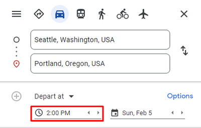

I played around Google Map by manipulating the depature, arrival time.
If google map direcdtion service is controlled by URL parameter, the URL should change if you change the depature, arrival time.  But as long as my testing is concerned, the URL was static, even after we change the Google Map dep/arr time.
This indicates there is no means to pass the parameter to Google Map URL to get your desired result.
Thanks for testing @Koichi_Tsuji In fact the URL is changing. But as I  wrote above, it contains so many strange data parameters. You can change the data parameter of the departure_time. But you cannot know the right data parameter for the address.
Thats contradict with what I observed in my environment, where URL not changing. sorry  no more help from my end.
