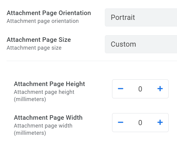

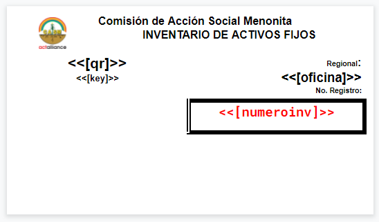

I have this exact same problem trying to generatea 4 by 7 cm sticker
The margins are BIG in the result but the template is fine with 0 marging and proper page size the result whatsoever is not the desired. I’ll try to increase the scale to see if I can further print the document to the size required.
This is the template:
This is the result
Hi @tecpme_casm if you’re on the new rendering engine (which had the overly large default margins), then you should now be able to specify custom margin values in the editor.
See the release notes here: July 16, 2021 - #5 by Greg_Denton
