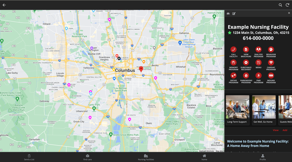

Hi Everyone,
I have users who are vision impaired and really struggle with certain elements of Appsheet built apps. I wanted to share a tip that may help other users while using maps. I know there has been some previous posts about KML usage but wanted to share for the specific challenge for those who may also benefit.
Applying a KML to the latlong or address column < here is what I used > can make it much easier to see pins on the map.
Before KML overlay.
Screenshot 2024-04-25 at 3.59.25โ€ฏPM.pngAfter KML overlay
 You can adjust the color / transparency in the KML file by opening in a text editor by adjusting the following tag  <color>997f7fff</color>
    <Style id="Style_5">
      <IconStyle>
        <scale>0.4</scale>
        <Icon>
          <href>http://maps.google.com/mapfiles/kml/shapes/star.png</href>
        </Icon>
      </IconStyle>
      <LabelStyle>
        <color>9900ffff</color>
        <scale>1</scale>
      </LabelStyle>
      <LineStyle>
        <color>990000ff</color>
        <width>2</width>
      </LineStyle>
      <PolyStyle>
        <fill>1</fill>
        <outline>1</outline>
      </PolyStyle>
    </Style>
 You would apply this in the database view to the column.
