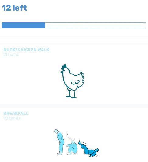

Very nice. Can I do something similar for images. I have a set of records in card view and want the user to focus on a single card at a time so i m looking to grey out the other cards. I can now reduce the opacity of the text but i m interested to do that for the image too.
Ideas? Thank you!
Perfect for text but would love to have something similar for pictures. Is there any way to do that without creating another image with low opacity for every image?
Sorry for the late reply @teambelair You can try using a XY column type in the card view. Because you can lighten up XY Background images.
https://www.googlecloudcommunity.com/gc/Tips-Tricks/Make-a-map-or-XY-background-image-lighter-or-dar...
You need to create or an extra child table for the XY, or you can use a self ref with a virtual column. Because you can add XY in a card only when it's a ref list.

Hi @teambelair I just did some testing and I'm sorry, but I'm pretty sure that this is no solution for your requirement.
It would look like this:
The Image is a map view inside the card view. That's why you see "Google" and all that stuff.
The map view has a secondary data table. I thought with that I can define when to show the KML to brighten up the image. But that's not possible, because only the KML for the first data label is respected. So you have the KML or you don't have it. We have asked many times to make the "Optional Url for KML File" configurable. But this is still not possible.
You can have a look at my App here. It's called "Transparency".
https://www.appsheet.com/portfolio/549987
So I think you should go another way. For example you could try an image API like this one:
https://www.googlecloudcommunity.com/gc/Tips-Tricks/IMAGE-EDITING-Rotate-Crop-Resize-Mirror-Etc-Usin...
Or this one:
https://pixelixe.com/docs/image-processing/brightness-image-api.html
Wow, this is nice, thank you very much
