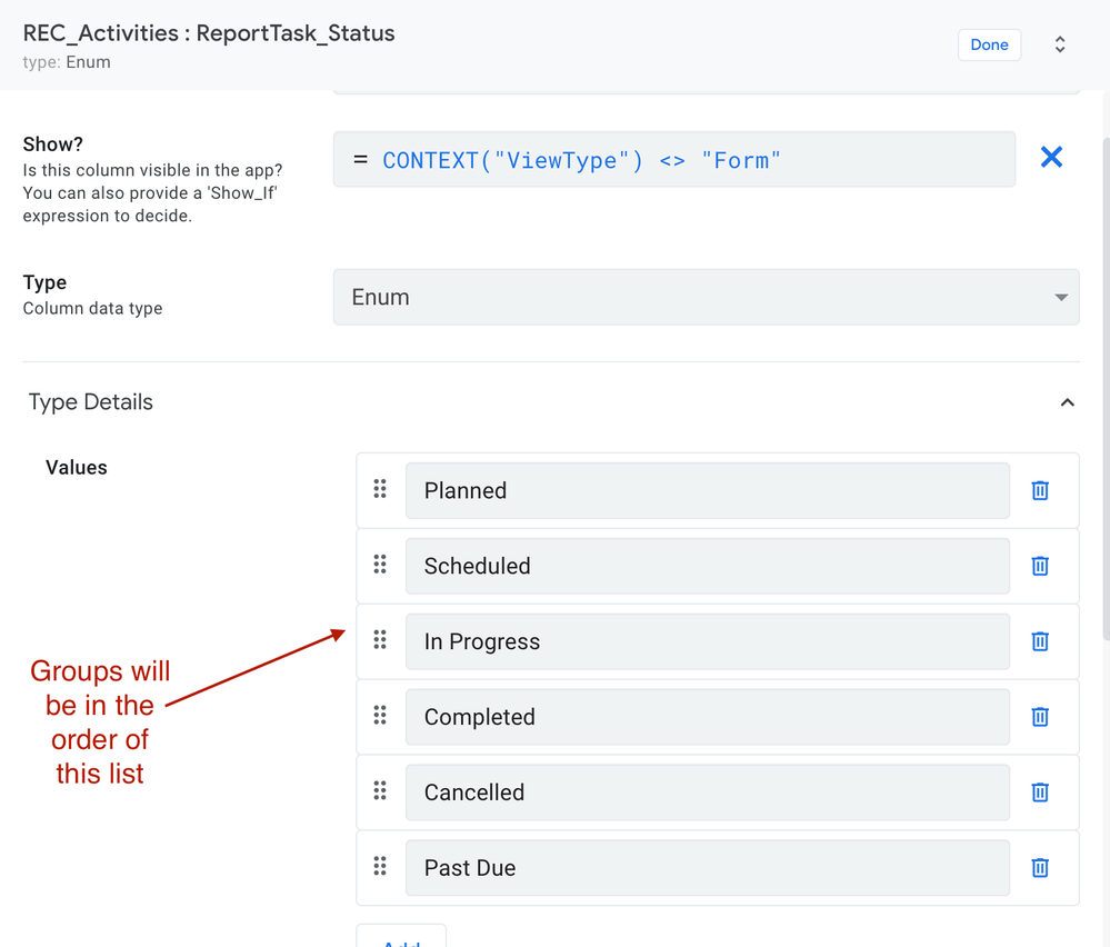

I just discovered this recently and thought I'd share it.  I have no idea how long it has been a part of AppSheet features.
If you have a Table view grouped on an Enum type column,  the grouping order will take on the order of the items listed in the Enum column.
For any column values that DO NOT appear in the static list, their groups are placed at the bottom of the Table view groupings and seem to be sorted as a secondary list.

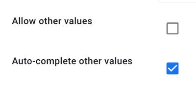

Just to add, this will only work if you untick 'Allow other values'
