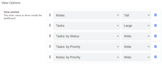

I suppose it still a challenge on how best to tackle column width customisation.
I suppose the following ideas would be a bit to complex to implement:
  1. Drag coloumn to size and save relevant to context of device like how the whole drag and size windows in a dashboard work at the moment.
  2. Have something like below where each column field can be adjusted. So default is loaded for each following which you can do a quick Narrow or Wide selection or a simple - or + option to increase or decrease buy a standard unit
I would agree that column width customization is an issue that has not be completely resolved. Heโ€™s I idea that might be of interest to you until a better solution comes along:
So my above idea on how to handle column sizing is well presented as an example in how you can customise dash sizes. Except the options are only controlling horizontal size on the column. So the options would be Default, Narrow, Wide, Extra Wide and Maybe then a customised size where you enter a size to ofset the standard. eg: Add 5 โ€œunitsโ€ more etc.
