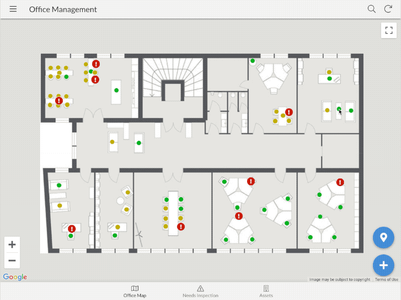

If you want to customize the base layer of your map view, consider ‘XY’ column types. When the column type is marked as ‘XY’ you’ll see the option in your column definition to link to a hosted image (that will serve as your map base layer).
After including a link to the map image, you’ll be able to add points to that image, just like you’d add lat/long points on a map. Your XY coordinates will be percentages across the height/width of the background image (50,50 will be the center).

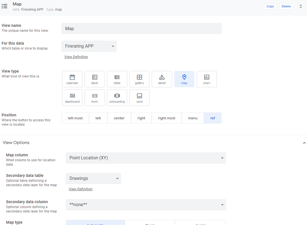

I’ve created a map view but i get all the point locations on a google map view not on the background image. Also is there any way to filter the points showing only the points attaced to that image.
This is the setting in my app.

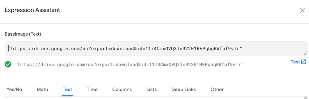

@Peter can you share what a link should look like for Background image? I am using Google Drive, and my link only gives me a blank screen?
Hi Michael, the link to the background image must be directly to the hosted image file (links that end in the image file extension like .jpg, .png). I don’t think this is natively supported in Drive, but you may find workarounds like this one: Google Drive Direct Link Generator
So, I used the Google Drive Direct Link Generator and it still if giving me a blank image. This is what I am putting in and what I am getting:
I’d recommend using a different image hosting service that provides a direct link to the file - Drive is not great for this.
Which other service do you recommend? I tried Dropbox and got the same issue.
