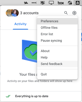

One of the best ways to get feedback directly to the team working on any Google product is to use the built-in "Send Feedback" functionality. The relevant team is far more likely to see the feedback there than in a thread on this site, honestly. As the name implies, this site is mainly the community of users using Google products--there's not a huge amount of traffic from actual Googlers.
In the case of Drive for Desktop on MacOS, that's under the gear icon in the Drive for Desktop menu:
Hope that helps,
Ian

How to Capture Google Drive for desktop logs for support:
You can collect log files in the app:
  1. On your computer, in the menu bar, click Drive for desktop
  2. Press and hold the Shift key and click Settings
     Generate Diagnostic Info.
  3. Youโ€™ll get a notification when a ZIP file of the logs is saved to your desktop.
Send the ZIP file to your support agent.
