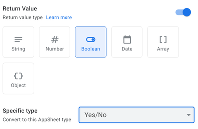

  1. Configure an Apps Script task as normal with a function that has a return value
  2. Enable the Return Value toggle at the bottom of the panel
  3. Set the AppSheet Return type that is returned from your Apps Script function
  • For example, if your function returns an array of strings, the corresponding AppSheet type will be a list of text elements
  1. Click the return type of your Apps Script function.
  2. Select the AppSheet type it should convert to in the drop-down.

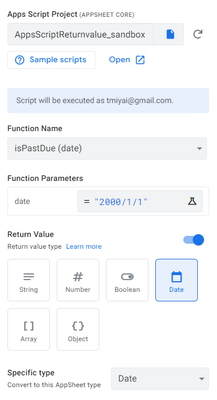

Hi @nico
isPastDue may need to be changed.
Passing "2000/1/1" did not yield a return value.
The following changes gave the expected return value.
function isPastDue(date) {
  // return new Date() > new Date(date);
  if(new Date() > new Date(date)){
    return new Date();
Takuya, the example in the post should be correct but the return value in AppSheet should be configured to be "Boolean" instead of a "Date" because it's just returning `true` if the current date is past the provided date "the due date" and `false` otherwise.
Of course you can modify it to return a date instead if you'd like for example:

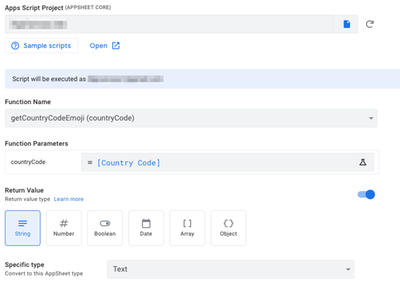

If anyone wants a quick-and-dirty script to try out this new functionality for a nonetheless real use case, here's one I put together. If you have a country code from a phone number, you can use a script (which in turn relies on an API) to get (and now return!) a corresponding flag emoji. I'm sure the script could be optimized in all sorts of ways, including trapping for errors and variations in what's considered a country code, but I confirmed it works at least in straightforward cases.
function getFlagEmojiForCountryCode(countryCode) {
  // Call REST Countries API (https://restcountries.com/)
  const response = UrlFetchApp.fetch("https://restcountries.com/v2/callingcode/" + countryCode + "?fields=alpha2Code");
  // Parse response
  const responseJSON = response.getContentText();
  const responseData = JSON.parse(responseJSON);
  let flagEmoji;
  let countryAlphaCode;
  if (responseData.length > 1) {
    flagEmoji = "N/A (multiple)";
  } else {
    const objCountryAlphaCode = JSON.parse(responseJSON)[0];
    countryAlphaCode = objCountryAlphaCode.alpha2Code
  // From https://dev.to/jorik/country-code-to-flag-emoji-a21
  const codePoints = countryAlphaCode
    .toUpperCase()
    .split('')
    .map(char =>  127397 + char.charCodeAt());
  flagEmoji = String.fromCodePoint(...codePoints);
  return flagEmoji;

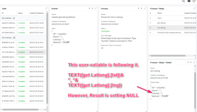

Hi @nico
I'm currently trying to achieve geocode functionality using return values.
It is a simple Apps Script that will return Lat and Long if the address is passed as text.
function geocode(address) {
 var response = Maps.newGeocoder().setLanguage('ja').geocode(address);
 for (var i = 0; i < response.results.length; i++) {
   var result = response.results[i];
   Logger.log('%s: %s, %s', result.formatted_address, result.geometry.location.lat,
       result.geometry.location.lng);
  //  return result.geometry.location.lat;
   return {
        "lat": result.geometry.location.lat,
        "lng": result.geometry.location.lng

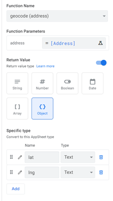

At this time, if I set the data type of the Key I receive in AppSheet to TEXT, the return value is Decimal, so I cannot get it and it will be NULL.
If I set it to Decimal, it works as expected.
There is nothing wrong with the functionality, but it is difficult to find the wrong data type in question because the error is not displayed in the Automation monitor nor in the Audit log.
I would like to see an error somewhere if the data type received is different.
 Thanks.
Takuya, thanks for trying out the new feature!

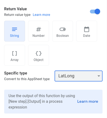

A few things I wanted to mention. If you want a LatLong translation, one easy wait to do it is to return it as a string like `"-28.05722, -51.75104"` then you can just configure it as returning a string with "LatLong" as the AppSheet type and you get it directly as a pin on the map etc.
And
   return result.geometry.location.lat + ", " + result.geometry.location.lng;
But there are good reasons to return it like an object if you want (e.g. to do calculations). In your first screenshot notice there is an error even the execution is successful: `Failed Apps Script Type Translation: Type 'Number' failed to translate to 'Text'`
I made the decision that the automation would still complete even if the type translation fails because some users may return different variable types on errors and I wanted to support that as well as not break existing workflows that might return different type.
There are two ways to fix that, either change Apps Script side to be strings:
1) Explicitly convert it in Apps Script (notice the `.toString()` at the end:
   return {
      "lat": result.geometry.location.lat.toString(),
      "lng": result.geometry.location.lng.toString()
2) Just configure it to accept a decimal on AppSheet (as you noted)
You've observed we're stricter on translating types from Apps Script. One "trick" I'll mention is that all types can be converted from a string to any type but not the other way around so a string like `"123.42"` to decimal is fine but a number like `123.42` to text will not work.
Hopefully that all makes sense.

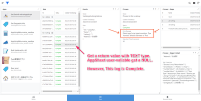

One thing I would like to discuss with you is that when it contains a wrong type error as we mentioned, I would like it to be clear in the Automation error.
Specifically, when similar error messages are included, I think it would be a feature that would be easier to use if we could display something in the log to draw attention to it, such as Warning instead of Complete.
Hi @nico
Sorry, same content.
I think it would be a more user-friendly feature for citizen developers if Status could be expressed in more detail regarding Automation Monitor.
For example, this is the log when I forgot to set the Return value in my Apps Script.
It is true that the Error message shows the contents of the message, but the Status is Complete, so it is not highly visible.
Especially for non-English speaking users, it may take time to identify the problem if the Status information is green.
Since most citizen developers do not have good debugging skills, I think this feature will be more widely accepted by a wider range of users if Monitor is made more user-friendly.🤗
Just want to validate your suggestion, I think showing a `Warning` here instead of a success or `Error` is a good idea since it'll be easier to find but we currently don't have a Warning state and adding one requires a wider Automation change. I've posted a bug internally but due to low severity it's unlikely it'll be prioritized in the near future.
Thanks @nico
That's right.
I thought the request seemed to have a large scope of impact, so I will wait patiently, hoping that it will be modified.
Until then, I'll keep an eye on the Error message!😃

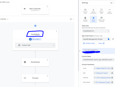

Hey @RensD I just saw this little bit of exchange and I can see what the problem is for you.  It's just a misunderstanding between what you are naming your appscript function (geocode) and the name of the Step that is calling it.
When you return values from Appscript and want to write them into a column, the system is expecting you to give the name of the Step, not the name of your script.
In this case, [geocode].[Output] is the name of your function and not the name of your step (task).
Here is a bot that calls a script
On the following task (StoreValues) the data that is returned from the script is stored in columns using the name of the Step.
[CreateNote].[Output]  NOT  [CreateNewNote].[Output]
Apologies if you have already solved this and I missed it!
Thank you. That was the trick. 🙂
Two ideas:
1. is the Task configured as a "string" return type in the Apps Script Task? Should look like this:
2. Like Marc is alluding to, you can only use this return value in the same process as you're calling the script in (but you can write it back to a table if you'd like to persist the value).

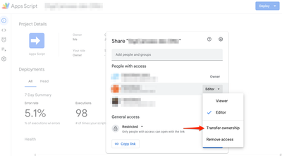

As I prepare to upgrade a production app to include new automations I developed in a non-production app, I have some questions regarding  potential constraints and hiccups related to Call a script tasks. I'm sure I can test these details if necessary, but it would also be helpful to get the answers documented here for everyone's awareness. Thanks, @nico or community friends who may have already worked through these details, for any guidance.
1. Shared projects
Is it possible for a Call a script task to reference an Apps Script project that is shared to the app owner? I don't see a way to select a project that is only shared to the owner. Maybe by adding a shortcut to My Drive?
I do see that it's possible to transfer ownership of a project. If an app task already references a project whose ownership changes but is still shared back to the app owner, will the task continue to function?
Screenshot: Seemingly no way to select a project shared to the app owner
Screenshot: Option to transfer ownership of project

Does a Call a script task always call a project's head deployment? Does it depend on whether the project has any versioned deployments? Is it possible to specify in the task a specific deployment version? Flexibility here would facilitate maintaining production and non-production versions of a script within the same project. Without flexibility, it's presumably necessary to maintain separate projects and point production and non-production apps to distinct projects.
3. Task properties persistence
If I change the project referenced by a task (e.g., to reference a production project instead of a development project from an upgraded app), do the task's other project-related settings (e.g., Function Name, Function Parameters, Return Value) persist or do they reset to blank and need to be re-entered even though they're the exact same values compatible with both projects?
Screenshot: Project-related task properties

1. Shared projects: If a GAS project is shared to you, add a shortcut to your Google Drive. Then you can select it from an AppSheet task and it functions fine.
If you transfer ownership of a GAS project that is already used in an existing AppSheet automation task, the task seemingly continues to function seamlessly with no changes necessary within the app. Upon transfer, it looks like a shortcut is automatically added to the previous owner's My Drive; I did not test whether there's a dependency on retaining that shortcut.
Note that it's not possible to transfer project ownership into/out of a Google Workspace organization (although maybe there's some workspace admin setting that could allow this). Nonetheless, it is still possible to share a project into/out of a Google Workspace.
3. Task properties persistence: If you change an existing task's Apps Script Project, all the other project-related task properties sufficiently persist:
  • Function Name: This property persists as long as the function is available in the new project. Even if it isn't available, the other properties do persist.
  • Function Parameters: These properties persist, and are helpfully flagged if they're not present in the new project's selected function.
  • Return Value: These properties persist; just like when they're originally defined, I think AppSheet doesn't validate they're actually returned by the function (e.g., the key names if the function returns an object).
