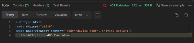

I'm having a problem with Apigee when trying to make PUT or PATCH requests, I'm receiving a 403 error. In addition, no call appears on the API proxy debug screen.

What could it be? There is an interesting bit of information in your analysis; you noted that the 403 message included this:
<title>403</title>403 Forbidden
That is not a message that gets returned by Apigee, by default. You could create an Apigee proxy to return that, but the Apigee system itself does not return messages that look like that, even when there is a 403 response . So what system DOES return a message that looks like that?
