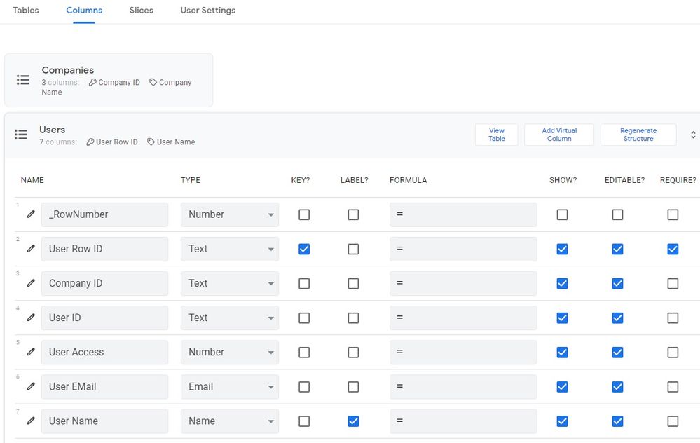

Please post a screenshot of the table’s column list from Data >> Columns in the app editor.
Hello, Steve. Just a small note here: I reconsidered the data structure, and I will delete the User Row ID column from this table, and will use User ID as a key. But I believe this is not related to the issue with action. (because User Row ID currently have initial value set to UNIQUEID())
