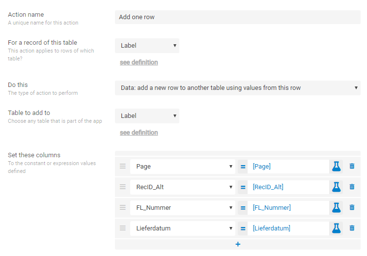

Interestingly, it is working when we use an Action Data: add a new row to another table using values from this row.
As you see in this screenshot, I don’t have to assign a value to the [Label] column.
