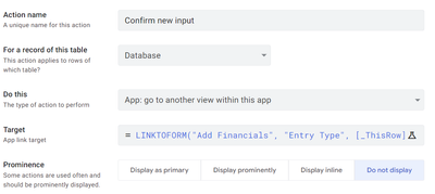

I managed to implement it the way I described. For reference, I set 2 new actions.
(1) Confirm new input (this is the action that the app will take once the user choose "Yes" in the dialog):
The LINKTOFORM formula I set up the way described in the previous comments.
(2) Input other period: this one is to show the dialog box
Note that on "Actions" I linked to the "Confirm new input" action just created above. This one I linked to my "Add Financials" view, as follows:
Hope this is helpful to other people.

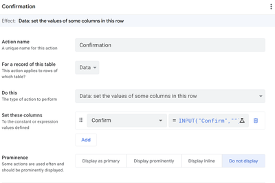

Yes it's possible with sequence of actions. You would need to have two actions in that sequence.. the first one will ask the confirmation (Y/N) with the INPUT("Confirmation","") action, and the 2nd one will decide which view it should show. It needs something like..
IF(
[Confirm]=FALSE, //this Confirm column is an additional column in your table
LINKTOVIEW("Data"),
LINKTOFORM("Data_Form","Customer",[Customer],"AnotherColumn",[Anothercolumn], etc.)

The first action is something like..
