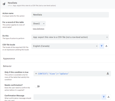

Please post a screenshot of the configuration screen for the action.
Hi Folks, here is the Action, a question if I may, I'm trying to have an action execute after a data update.

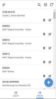

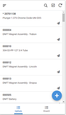

Here is the view:

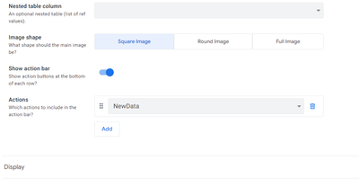

The Action is also set in the view. If I remove the Behavior Condition the action does appear on the view.
(below) but a trash can appears on the main view now for some reason.
Show us the whole action config, including "Appearance"
Well I can't explain this, this would not work Yesterday but is working today:
Here is the appearance:
The only real difference between the two days is yesterday I was using an existing view and this field was not available in the existing View but was present today when I created a view:
This is resolved, it would appear that the Actions can only be added to Primary views. Thanks for the help.
