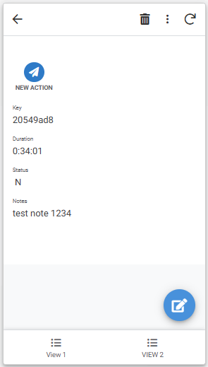

Photo 1 - The detail view of sheet 1 row

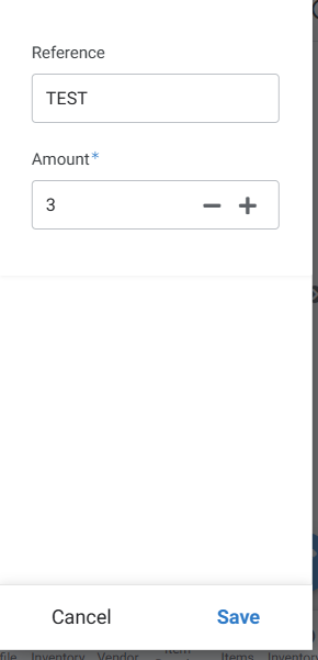

Photo 2 - The Input window for the record made on sheet2 visible in the detail view of sheet1 row detail view.

The only thing I can help further on is if you share photos of the setup, but make sure there is no PII or company sensative data. There has to be a way you are setting it up that is causing the issue.
