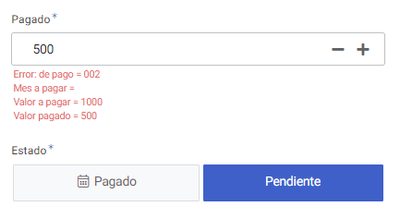

You mead as this
hello, can you tell me how did you do that? line break in Invalid value error?

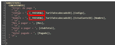

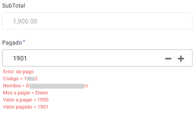

Sorry for the late reply, for example for this result
I use this formula, You must use substitute because otherwise it will make a single line, For separate lines you should use it
I hope this solves what you need
Regards
The _THISROW dereferences are unneeded here:
Thanks for correcting me
