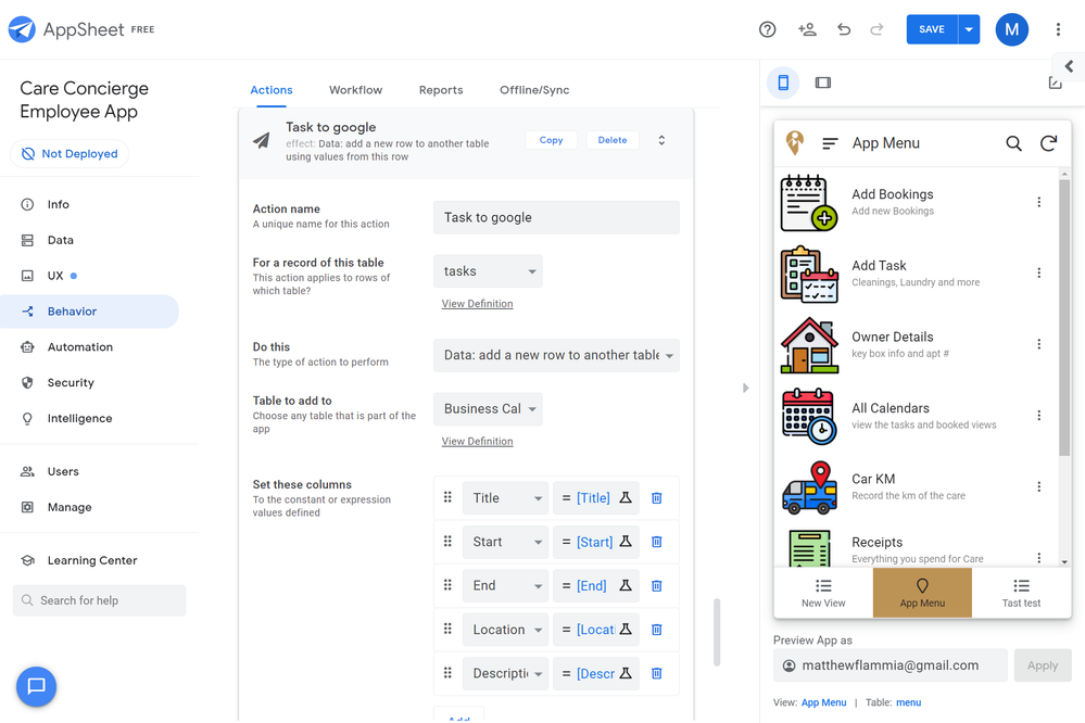

Hi Guys!
Thank you for this post, I did exactly the same as Nicolas. I used the google calendar source and used it as a form to add cleaning tasks to my cleaning business, but after a couple of weeks our company realized we needed more info so we changed to another table and followed your details to have just the basics ( TITLE, START, END, DESCRIPTION) added to google calendar.
The issue is we cant seem to find out how to have the data automatically go into the google cal table. we keep having to manually press a button in another UX view to push the data to the google table.
Is there a way to have it so once we finish our Tasks form and send it will automatically update our tasks table and the google cal table?
Setup a “data: add new rows” Action, to run as the Form Saved event for the Form that you are saving.
Hi Marc
thanks a lot for the quick reply, also I have done exactly what was previously written above and everything works perfectly but the only issue is that the data doesn’t go to “Business cal” (google) without me having to go into another UX view “tasks” deck view and manually press the action button to see it in google cal.
I’m sure it’s super simple but at the moment I haven’t been able to understand why it’s not automatically adding the data to Google.
again I appreciate the help
Did you do this part?
Perfect Marc!
Thank you! everything works
