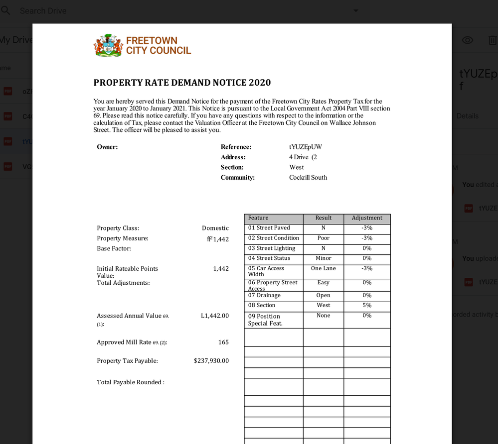

Reza2
Can you provide screenshots of the template and created PDF, so we could compare the margins?
Top is the template in Word
Below is appsheet PDF

Well, from what I can see in the above picture your template document currently has left and right margins; have you tried going to page setup and change them to zero?

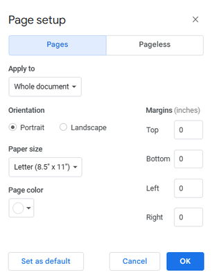

I thought I would add my experience here because I have had a lot of frustration with margins, whether I use a Google Doc template or an MS Word template.
However, I have had recent success that I'd like to share. I hope I'm not repeating someone else's discovery.
I used a Google Doc in this solution, but it also works with an MS-Word document.
1. Set the margins in your template to 0.0. For Google Docs, use the File > Page Setup and set the Top, Left, Right and bottom values to 0.0

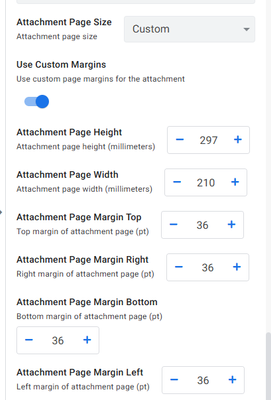

2. In your App Sheet template, set the  "Attachment Settings >  Attachment Page Size" to "Custom", and then set the dimensions and margins of your page. For a letters size, this is 297mm height x 210mm width, with top, right, left and bottom margins at 36pt (that is 0.5 in)
And now I have output that seems to behave properly.
