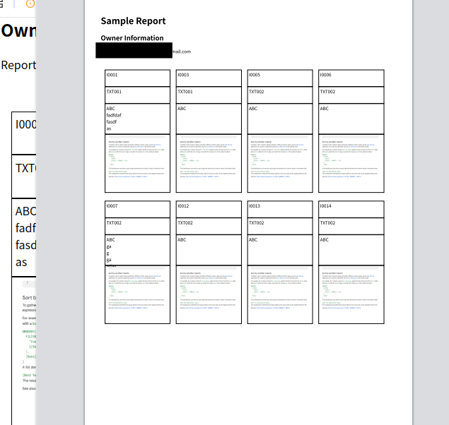

 Below is an example template that I tested with. Make sure that you enclose each column in a separate table cell and each cell height should be the maximum size for alignment.
This is a sample report

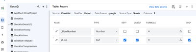

I have tried your suggested solution but it still does not work.
What I  have done so far:
1- I created a table named Report: With id.rep as ref to DetailID in ChecklistDetail:
2- I copied the DetailID content in id.rep report:
And adjusted my template as follows:

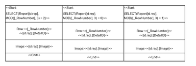

Here is a screenshot of my google doc template:

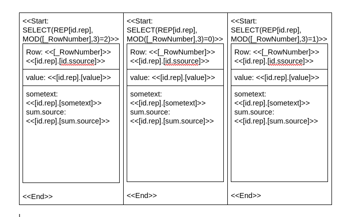

You need an outer table of three cells.
Then in each cell insert an entire column from <<Start>> to <<End>
I have already added a table named Report with these columns:
I mean an outer table in the template. Please see my sample template carefully.
Also, you do not want the checked column in this Report table.

The problem you have is the template. You have to have tables inside a table.
You only have one table. But as I said, you create a table with three cells and in each of them you enter the data expressions starting wiht <<START: ...>> and ending with <<End>>
I see now , you mean the structure of the table is incorrect.I will give it a try and back to you.Thank you again
Here you have an outer table whose borders are red in color.
Then in each cell is an embedded table to render each column.

Like that , If I am correct:
<<Start :
SELECT(Report[id.rep], MOD([_RowNumber], 3) = 2)>>
Row:<<[_RowNumber]>> <<[id.rep].[DetailID]>>
Image:<<[id.rep].[Image]>>
Checked:<<[id.rep].[Checked]>>
<<End>>
<<Start:
<<End>>
<<Start :
<<End>>
Correct. you still have to change the right hand side of the mod expression to render the correct group in each cell.

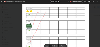

After some tweaking I get it working though not on the form I want but I will try to adjust it until I get the desired form:
Here is what I have now as template:
and here is the output:
It still needs more adjustment as I have all the first page empty and images are not with the same size.What would you suggest as more adjustments?
I want to put 4 columns instead of 3 since the page fits.
Best regards,
Just use a four cell outer table and MOD of 4.
I also mentioned " each cell height should be the maximum size for alignment" in my initial post.

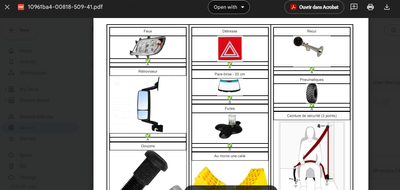

     I have made it work .Thank you so much.I have to unify the size of my images to better fit in the images cells.
Now they are the output looks like that:
I am so grateful for your help

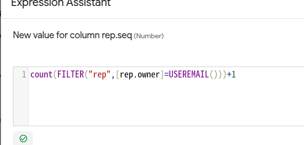

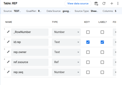

One way to handle multiple users...
- Make the report table like
[id.rep] = UNIQUEID()
[ref.ssource] is a reference to the Data table

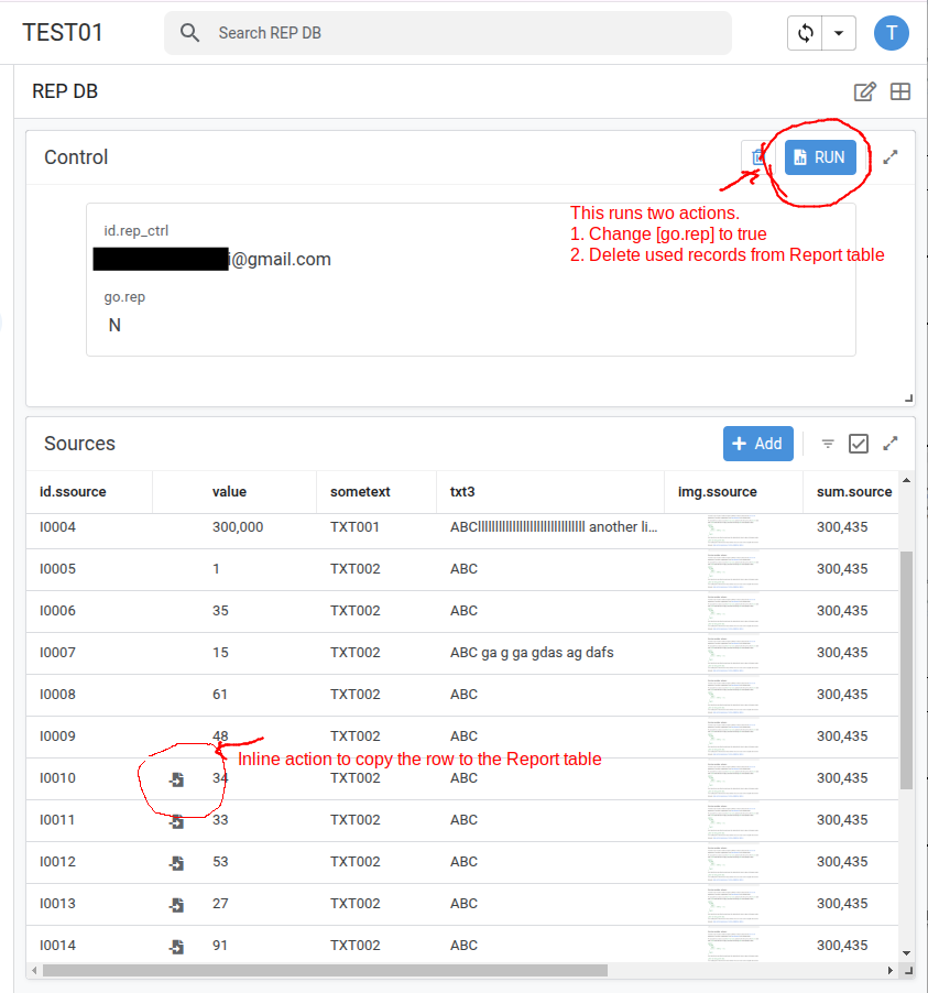

- Create an action on the data table that copies the selected row to the Report table and attache it to a place holder VC (app formula = ""). You will see a picture later in this post.
[req.seq] acts like [_RowNumber] now.
Set its behavior so that once copied to the Report table, the icon disappears.
- Also create a Report Control table like
You can create a slice of this table to only show the row corresponding to the logged on user.
- Create an action to run the report which modifies the [go.rep] to TRUE.
- Create a bot to run on changes to this Report Control table with a condition that [go.rep] is TRUE
- Then the template' START expression should be modified like
<<Start: SELECT(REP[id.rep], AND([rep.owner]=[_THISROW].[id.rep_ctrl],MOD([rep.seq],3)=1))>>
- On the Report Control table, you can create an action to delete the records on the report table and create another action to run both Run Report and this Delete at the same time.
- Create a dashboard to show a detail view of the Report Control Table's slice and the source Table
Here you can see (or not see rather) the rows that are already copied to the Report table.
Hope this helps.

    <div class="page">
      <h1>Sample Report</h1>
      <h2>Owner Information</h2>
      <p>Report run by: &lt;&lt;[id.rep_ctrl]&gt;&gt;</p>
      <br />
      <div class="external_frame">
        <p>
          &lt;&lt;Start:
          SELECT(REP[id.rep],[rep.owner]=[_THISROW].[id.rep_ctrl])&gt;&gt;
        </p>
        <div class="record">
          <p class="cell">&lt;&lt;[ref.ssource].[id.ssource]&gt;&gt;</p>
          <p class="cell">&lt;&lt;[ref.ssource].[sometext]&gt;&gt;</p>
          <p class="cell size100">&lt;&lt;[ref.ssource].[txt3]&gt;&gt;</p>
          <p class="cell size200">
            &lt;&lt;[ref.ssource].[img.ssource]&gt;&gt;
          </p>
        </div>
        <p>&lt;&lt;End&gt;&gt;</p>
      </div>
    </div>
  </body>
</html>
As far as the google doc template is concerned , I am till now satisfied with its output.What matters most now is avoinding contradiction in using the Report table when multiple users are using the app especially at the point of copying and clearing the report content when generating the PDF file.I am really grateful for the explanation you have made above.My data table (source table) is displayed in a deck view with inline actions run from there and multiple users may run actions simultaneously.Does the solution serve in this case.
Here is a screenshot of my source table:
The action underlined is the one that creates the template.
Also , I have not understood how the adjustments you have made can avoid cross copying and clearing for multiple users even when I have only one table used to create the template.
Furthermore, each user copies all the rows related to his checklist from the source table (ChecklistDetail) and not only one row.This is a screenshot of my source table:

This is two different users selecting his own set of rows to report. See the REP table and how the records are identified by the [rep.owner]. Also I0006 are selected by both users.
This is the status immediately after the second user pressed RUN and the completed rows are deleted. His action does not affect the first user in anyway because they work independently because of the owner field.
Ok. In my case , I have changed the content of the SELECT expression to:<<Start:SELECT(Report[id.rep],AND([id.rep].[ChecklistID] = [_THISROW].[ChecklistID], MOD([_RowNumber], 5) = 4))>>
Adding :"[ChecklistID] = [_THISROW].[ChecklistID]" to each Start expression as the ChecklistID is the non common element between checklists so that each user can create his own checklist file .Does this help in avoiding contradiction in creating PDF file?

It seems working but I have a problem on how to delete only rows related to the checklistID whose pdf has been created, because now I have an action that deletes all the rows in id.rep  not taking into account the ChecklistID.
Shall I add ChecklistID to Report table?
