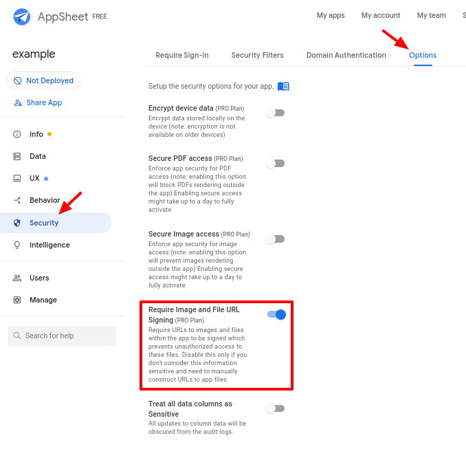

Maybe you need to toggle this? Iโ€™m guessing, here.
This is our security settings although we have apps that have require signing enabled and disabled and both dont work.
