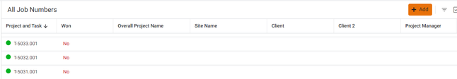

The main data source will be set out similarly to the below.  The Project and Task number will be unique for each job and can be used as a reference between different notes and records.
I want to be able to click on a Project and Task number and be able to view and add notes similar to below

Instead of using the Input Function, I would rather go with a new table and set it up like a comment function.
Add a new table called "Notes", with ID, ProjectID, TaskID (if needed), Note, PostDate, User.
Then within the newly created table, reference ProjectID and TaskID to the respective tables ID.
Give the view "Notes_Inline" a new styling like "Card" and layout "list" and display it in the views.
And with this, you'll have a new table with all notes, connected to the Projects / Tasks and you are able to add as many notes as you want.

In addition to @Tammer 's indication, here is the documentation relating to References between tables. A few examples may help you here.
References between tables - AppSheet Help
Display referenced records - AppSheet Help
