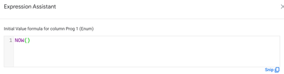

@franc @Steve I tried to add now() in the auto compute section but it says "Key column 'ID' in Schema 'Sheet1_Schema' cannot use an app formula. The app formula will be removed". is it that we can't automate key column using formula?
@dhaval if added in the following field of the auto compute section, the "initial value" field, it should work fine.
Yes! it's working, thanks!
