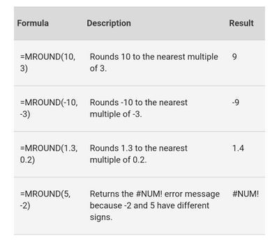

Almost
@WillowMobileSys wrote:
FLOOR([value] / [factor]) * [factor]
Use ROUND() instead of FLOOR()
ROUND([Value]/[Factor])*[Factor]
 Taking these examples:
ROUND(10/3) = ROUND(3.33333) = 3;
3 * 3 = 9
ROUND(-10/-3) = ROUND (3.33333) = 3;
3 * -3 = -9
ROUND(1.3/0.2) = ROUND(6.5) = 7;
7 * 0.2 = 1.4

Almost
3 * 3 = 9
3 * -3 = -9
7 * 0.2 = 1.4
