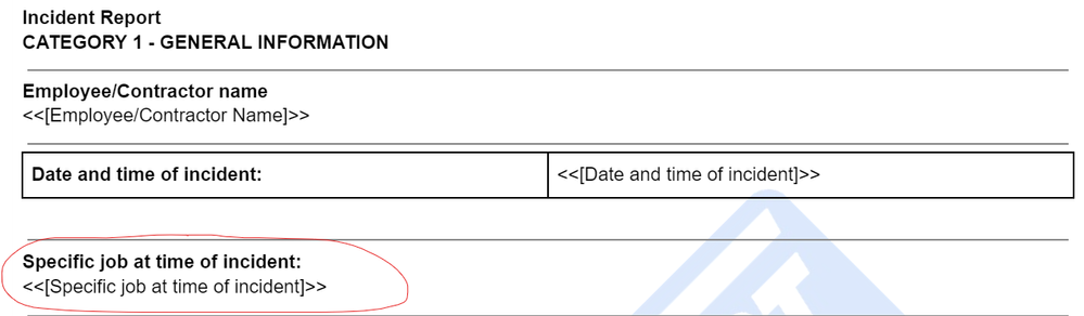

Any way to only have section in PDF display if they have a value in app?
So I am creating a large report, but there are lots of fields that may or may not be filled out depending on the circumstance. I would like to have my PDF set up so it only displays the headings and results for those fields if data is entered. I know the information inside of <<>> will display as blank if no entry, but how can I get the whole section blanked out? Is there a way?

Thanks for the response. Any way you could put the syntax up based on the example I sent as to how I might implement it? I am not sure how I would build the expression.

Does this syntax look correct? I confirmed I labeled the field exactly as it is in the table but it is not outputting anything to a PDF since making the change:
<<If: (ISNOTBLANK[Job_at_time_of_incident])>>
Specific job at time of incident:
<<[Job_at_time_of_incident]>>
<<EndIf>>
Small typo in here.. <<If: (ISNOTBLANK[Job_at_time_of_incident])>>
It should be <<If: ISNOTBLANK([Job_at_time_of_incident])>>
Perfect! That worked. Thanks so much! You all are awesome!
