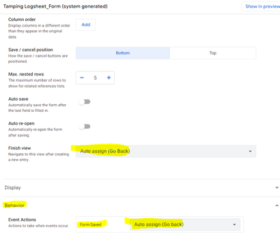

First go to that form view in UX and set which View you want to see once you saved the form. Go to that Form View in UX and go to Behaviour  and you can find this option to set up the view .So once you save the form you can directly see the data in a detail view.
To avoid the same row added again and again you can set any one column or more than one column as a unique keys. So the user will not be able to add the same record again.

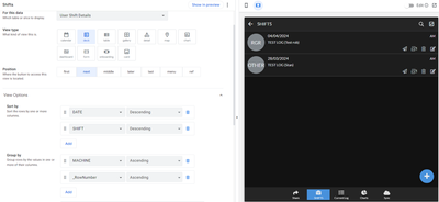

Thanks but i think the views are all working fine in terms of moving from 'Form' back to 'Detail' UX (pic below shows settings) and it initially goes back fine with the new data visible (before the delayed cloud sync executes)...but once the cloud sync is all done the last entry is removed on the display refresh (though the related # record count still shows the correct number). The duplication happens because the users thinks the data is lost and adds another row entry, but then after a few minutes of adding a new entry and syncing the missing entry comes back. This app has been working fine for years with no issues and I haven't modified anything in the back end recently. I felt it might be more to do with my sync settings or the delays in getting into our company SharePoint but I would have thought it should be using the data on the mobile device as its display source??
