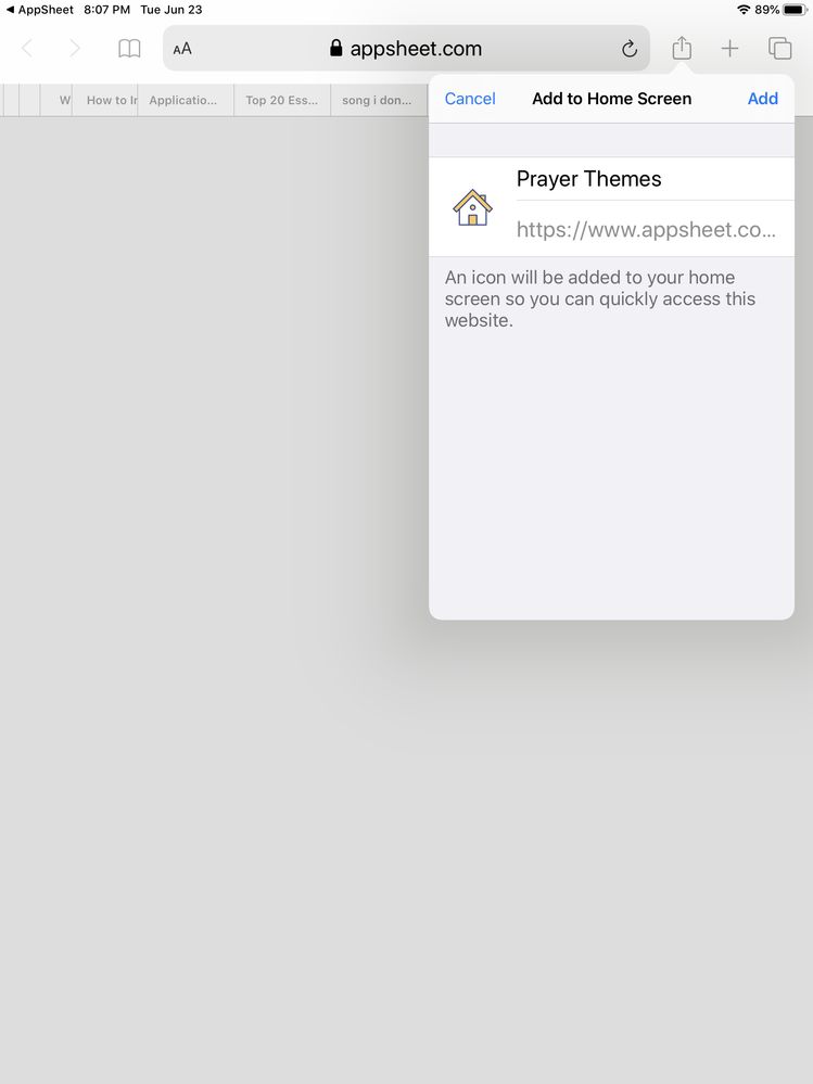

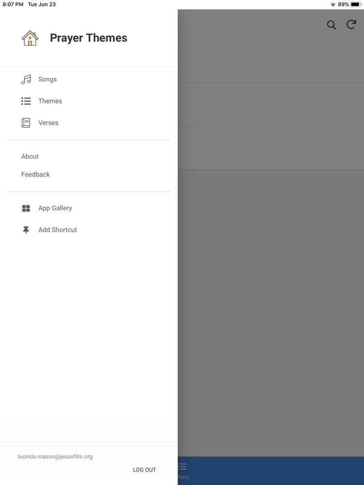

Iโ€™m using AppSheet on on iPad with iOS 13.3. These steps work for me.
  1. Open app from AppSheet icon. Click on Add Shortcut.

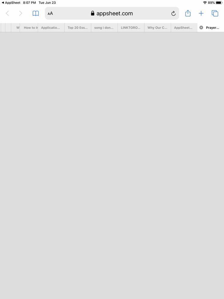

Goes to a blank safari window. Click on the box with an up arrow to the right of the url box.
Select Add to Home Screen.
Click add.
I log in via Google and it stays logged in, even when I delete the shortcuts and AppSheet and start all over.

Success! It worked perfectly. Thanks again Lucinda

I know this thread has an answer, but I found that if you have Chrome set as default browser (maybe other browsers as well?) you need to start the process from Safari.  Once in Chrome then use the share icon (box with up-arrow) to set the desktop icon.  This seems to install the app.  However, if you have embedded YouTube URLs they will not work in this mode.  You'll need to run the app in a browser.
