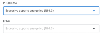

I have a requirement: I would like to append value to a List (in a Form View) when values of a column change.

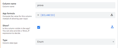

1. I've a virtual column "PROVA", type Enum, valorized with values from another column [BILANCIO] (I've renamed [BILANCIO] in "PROBLEMA")
2. So, when I select a value, on the Form view, for the field "PROBLEMA", this value appears in the enum field "prova:
3. My need is that if in column PROBLEMA I change the value, this new value appears as second element in the "prova" enum field (and so on.... every time I change a value, the new selected value appears at the bottom of the "prova field").
4. For now, when I select a new value in PROBLEMA, this replaces the old value in prova:
Thank you so much for the hand,
Lorenzo

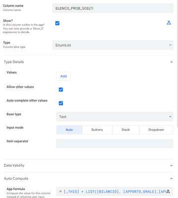

1. I've entered this expression in the "AppFormula" of a data source column ([ELENCO_PROB_SCELTI]), EnumList type:
2. I'd like  that by choosing different values of the fields [BILANCIO],[APPORTO_ORALE] or [APPORTO_LIQUIDI], the last value on the EnumList column ELENCO_PROB_SCELTI is the last values choosen by the user.
3. Using the following formula , it doesn't work in a good way.
[_THIS] +
LIST([BILANCIO], [APPORTO_ORALE],[APPORTO_LIQUIDI])

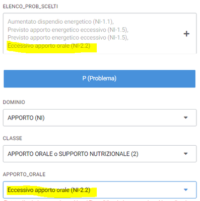

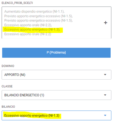

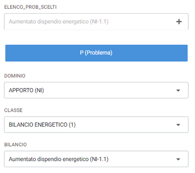

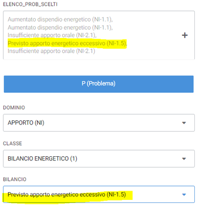

a. I choose a value of [BILANCIO]: it is correctly reported on ELENCO_PROB_SCELTI
b. I choose a value of [APPORTO_ORALE]: it is correctly reported on ELENCO_PROB_SCELTI in the last position (though the value selected on [BILANCIO] appears twice)
c. If now I change the value already selected in the [BILANCIO] field, it doesn't appear in the last position of ELENCO_PROB_SCELTI:
