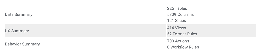

Here is one of my apps and its statistics.
