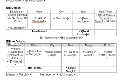

I need to show all the data from all the Bills on the PDF that comes from Invoices. The first screen shot is showing the working table [Parent Bill] as the primary data source with the table showing [bills] data.
This pdf works great for bill review and partial invoice review.

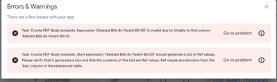

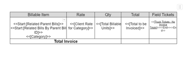

But... when I one level above to the [invoices] table, I can not get my references straight, this is what I tried, but I am lost.
This PDF comes from the [invoices] table but should show all [bills] details from all of the [Parent bill] tables.

It is still not clear if the field names such as "QTY" ([Total Units]) etc. are from grandchild table or not. Anyway assuming those are from grandchild table, please try as below. Please share screenshots of grandchild table as well if needed.
if understanding of your requirement is correct, you wish to print all related records from the grandchild table "Bill" for an "Invoices" table record.
If so, please create  a VC called say [All Bills]  in the grandparent table "Invoices" with the following details of this VC configuration
 A) list type with
B) element type as ref and
C) reference table name as "Bills" with
D) an app formula expression something like
SPLIT(TEXT([Related Parent Bills][Related Bills by Parent Bill ID])," , ")

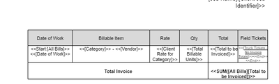

Then your template expression can be something like below
This bot will invoke from the grandparent "Invoices" table.
Please try
SUM([All Bills][Total Invoice])

That worked well, thank you! and Yes, you had the tables correct, for the hierarchy.
One more question, I have the Total Invoice column for each line, what is the best way to sum that?
I appreciate all your help!
Please try
Thank you! I sincerely appreciate your help!
