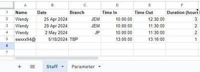

I am facing a challenge. When user time-out with the form, the bot that I set up doesn't update the value to the existing time-in row. Instead, it has become a new row.
---Current (Wrong)---
---Expect---

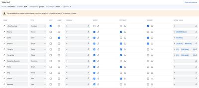

This is my Staff Table setting:

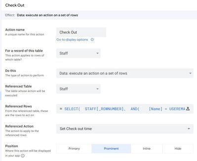

This is my Check Out Action:
Referenced Rows:
 SELECT(
      STAFF[_ROWNUMBER],
      AND(
        [Name] = USEREMAIL(),
        [Date] = TODAY(),
        [Branch] = [_THISROW].[Branch],
        ISBLANK([Time Out])

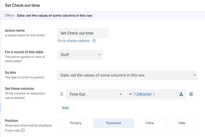

This is my Set Check out time Action:
