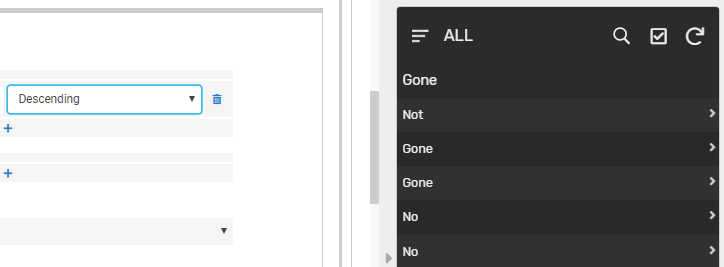

[1st Picture] I have a simple table containing a column named “Gone”. The column keeps 2 possible words; “No” and “Gone”.

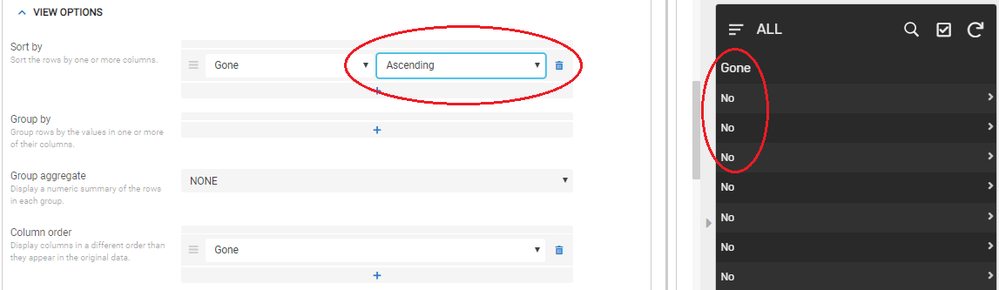

[2nd Picture] In UX, setting “Sort by” in “Ascending” order makes “No” come before “Gone”.
[3rd Picture] “Descending” order makes “Gone” come before “No”.
Why are they upside-down?

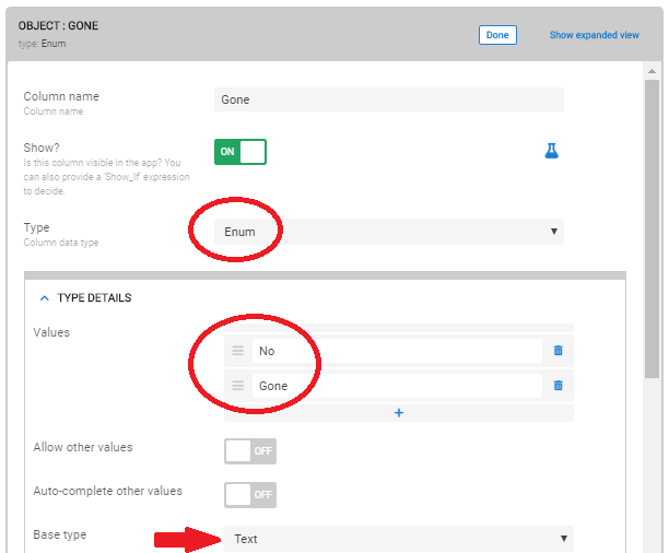

I tested more deeply and it seems that if the option “Use other values” is not set as ON, it will follow the Enum field’s option called “Values”. Now when you have them as an order No > Gone and that option is set as OFF, this will happen.

This behavior is the same on both the Editor’s emulator & on my Android phone. I have to use “Ascending” as work around.

I think I found a clue. If I move the Values upside down to “Gone” and then “No”, the view sorting is correct.
However, the sorting algorithm in AppSheet should not be depend on the order of the Value itself. It should rely on the content inside column, not the sequence of the list.
Thank you.
I finally choose to change “Allow other values” to “ON” and keep the “Input mode” as “Buttons” to prevent users from adding any new options. Now I can use “Descending” which looks more rational.
