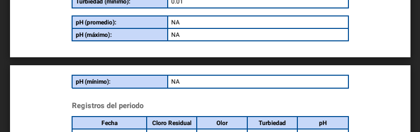

PROBLEM: When the file is made the margins (mostly top/bottom) are not respected.
This is the bottom of the first page and the top of the second page.
1 12 508

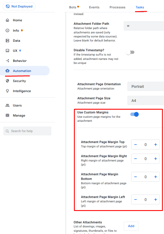

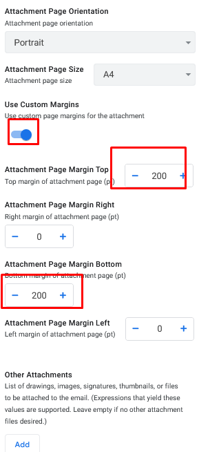

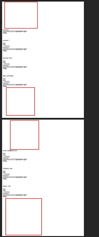

Those “Custom Margins” setting do not work. The top margin only sets the margin for the first page and the bottom margin only sets the margin for the last page. If the document is 3 pages and you set the top margin at 35 points and the bottom margin at 35 points:
  • page 1 top margin will be 35 points
  • page 1 bottom margin will be 18 points
  • page 2 top margin will be 18 points
  • page 2 bottom margin will be 18 points
  • page 3 top margin will be 18 points
  • page 3 bottom margin will be 35 points

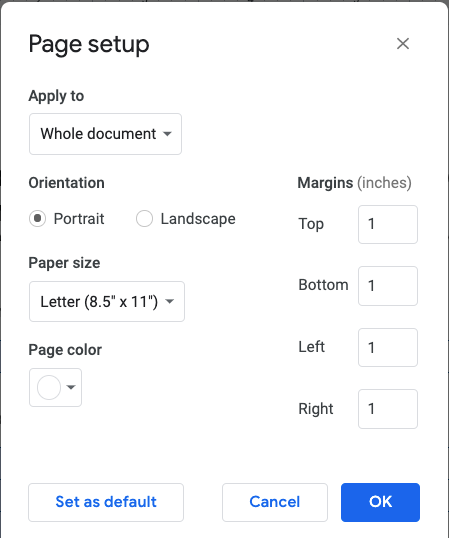

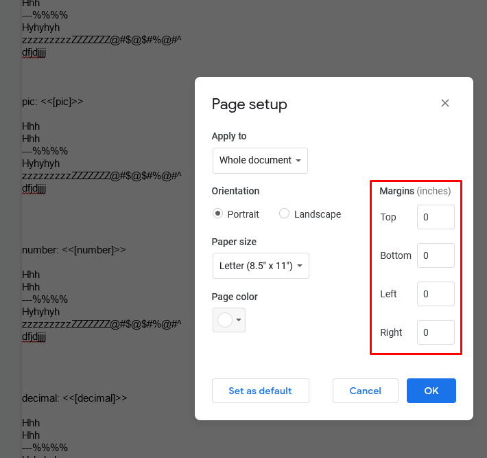

It works for me.
thank @Marc_Dillon it does not work for me. One thing I see you did different than I did is setting the margins in the Google Docs to zero (or marginally close to zero). I am going to change them and try it out. Appreciate the feedback…
